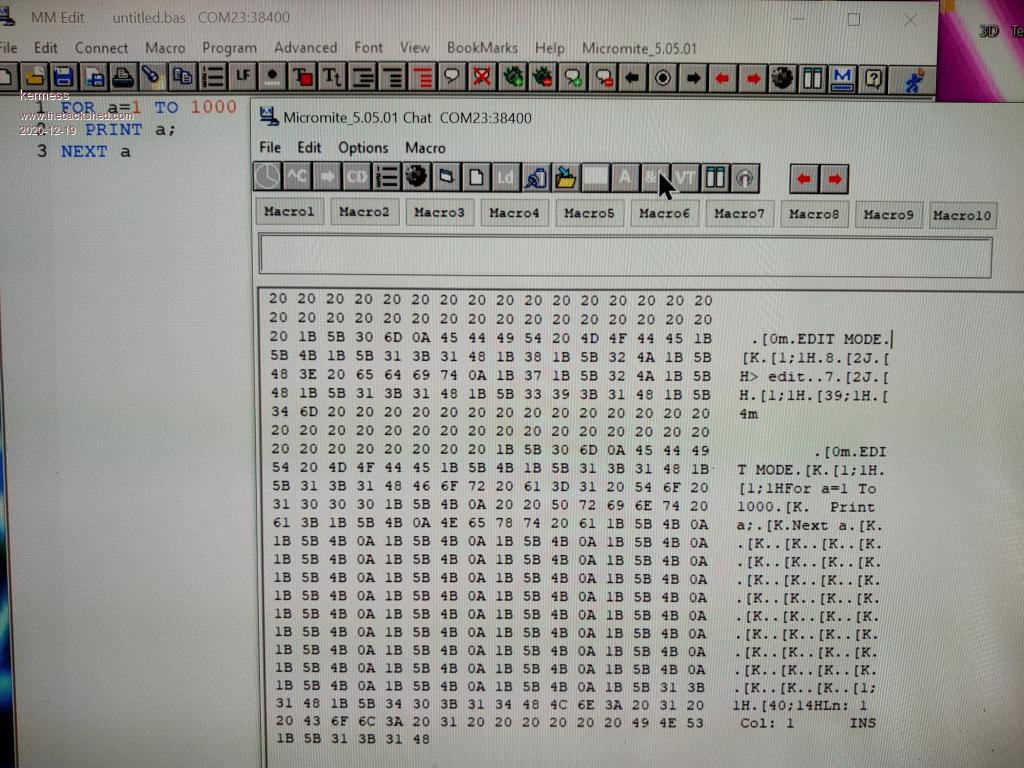

Hi.
I am trying to work on three prototypes with the PIC32MX170 with stable version 5.05.02 and 5.05.03
Work with Win 10
Until two weeks ago I had no problem in those three prototypes, I was using MMEdit 3.8.1 and "I think" that since I mounted the version of MMEdit_setup4.x.exe to connect the CMM2 I started having problems.
Once the PC is connected as always to MX170 through the COMXX: adequate and I observe minimally that it works .... list, run, print ... etc ..
When I go to "F4" or EDIT the written program is not seen on the screen ... black screen ... if I press the "Enter" key I can view the program for a second but it turns black again.
The last line ... ESC: Exit F1: Save F2: Run F3: Find F4: Mark ... etc ...
This line I can't see is black.
But if it is functional F1, F2, etc ... they work but it is not visible.
I have tested with these two versions of TeraTerm 4.101 and 4.105
I have uninstalled and installed several times and the two different versions of both MMEdit and TeraTerm and EDIT does NOT work.
Has anyone had this bad experience ... ???
A help ... thanks.

Posts: 6606
Posted: 11:27pm 16 Dec 2020
I have no idea what is happening.
Can you try this:
Using MMEdit
connect to your micromite and open the 'chat' window
switch to VT mode
start EDIT and enter the test program until the problem appears.
Switch MMEdit to HEX mode
Copy the full window and paste it into a text editor such at notepad.
Paste the results here.

kermess
Joined: 04/04/2013
Location: Spain
Posts: 50
Posted: 06:19pm 18 Dec 2020
Hi.
Reply message to TassyJim.
In this picture you can see a minimum of "Program" and the result in HEX.
Process.
> edit "Enter"
In Edition the three lines appear and in a second they move upwards and disappear in this minimum program it remains on the screen
  Next a
Below, the EDIT MODE line comes out but broken and part of the line is seen.
.................. n: 3 Col: 1 INS
And this is the result in HEX.
Muchas gracias.

Posts: 6606
Posted: 08:19pm 18 Dec 2020
I don't understand where "EDIT MODE" is coming from.
What do you have set for "OPTION DISPLAY lines [,chars]" ?
Try setting it to OPTION DISPLAY 24,80
You can also try using the test server which is running MMBasic V5.05.03
Menu Connect/Test server.
kermess
Joined: 04/04/2013
Location: Spain
Posts: 50
Posted: 10:37pm 18 Dec 2020
Hi Jim.
Thank you. 1000 thanks.
I've done it a thousand times but when the cables cross you don't get off the donkey.
This is what I did ..... OPTION DISPLAY 80,38 and there is the problem.
I just had to get it right.
OPTION DISPLAY 38,80 ..... and problem solved.
The confusion in the order lines / columns has come to me from how it is presented in TeraTerm and it had not occurred to me to put it backwards.
Thanks a lot.
David.
