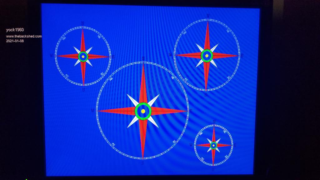

I worked on that code quite a bit more after that...it was like an 'ear worm'!
Here it is, in a little demo, but contains a standalone 'compass' subroutine. Basically, I had to use trig functions for everything.
Steve

lew247
Joined: 23/12/2015
Posts: 1709
Posted: 09:30am 08 Jan 2021
Steve
Compass.zip
That code looks amazing.
It's just a shame it won't work on Pi-Cromite
This is what I've done with your previous code
The red triangle rotates to the current wind direction
Lewis
Edited 2021-01-08 19:35 by lew247
yock1960
Joined: 18/08/2020
Posts: 167
Posted: 09:54am 08 Jan 2021
Nice!
Steve
