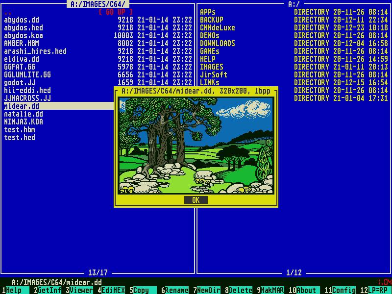

because of need in Napoleon Commander, I wrote small graphics library and finally thought it could be useful also in other projects, so I moved it to separate repository. Right now it can just few things:
FUNCTION GRF.info(pg AS INTEGER) AS STRING
 return MODE, BPP, y-lines, pg address, write address
 it's mainly combination of MM.INFO
SUB GRF.saveBMP(filePath AS STRING, xx AS INTEGER, yy AS INTEGER, ww AS INTEGER, hh AS INTEGER, pp AS INTEGER)
 save BMP file from screen memory on xx,yy with size of ww,hh from page pp
 it takes bpp from current MODE (so either 8 or 16) = makes BMP smaller than MMBASICs 24bpp
 saves image also from other page as 0
FUNCTION GRF.getImgInfo(filePath AS STRING) AS STRING
 return info about graphic file, WIDTH, HEIGHT, BPP, VERSION
 works now just for BMP, PNG, GIF
FUNCTION GRF.loadImg(filePath AS STRING, xx AS INTEGER, yy AS INTEGER, pg AS INTEGER) AS INTEGER
  load image to x, y, page
  returns 0 when NOK
FUNCTION GRF.getC64info(filePath AS STRING) AS STRING
  get info for some C64 formats (Koala, HiEddie, Doodle, HIRES)
FUNCTION GRF.loadC64(filePath AS STRING, x AS INTEGER, y AS INTEGER, pg AS INTEGER) AS INTEGER
  load some C64 formats to x, y, page
  returns 0 when NOK
FUNCTION GRF.getCMMcolor(n AS INTEGER) AS INTEGER
  get color from standard CMM (for sprites)
I would like to extend it, but I have few issues, so I need somebody for help:
* loaders for RLE Doodle and Koala (.jj and .gg files) - I don't know way, but I'm no able to do it properly. They are just simple RLE with $FE as RLE sign, but...
* loaders for some other 8-bit formats (from ZX Spectrum, MSX, Sord, Amstrad...). I can write something from Atari ST (Degas...), but other computers I didn't owned, so I need at least to know, if is it interest and what format is most important
* GIF87a loader
* get width and height info for JPG. I'm using for BMP, PNG and GIF MMBasics loader, but I'm loading it to other page than 0 and later resize it to window, so I need to know size
* maybe something else ?
Right now the library is built so, that basic formats (BMP, PNG, GIF, JPG) and C64 formats are separated, it's because to have for every format own FUNCTION/SUB (info and load) will bring too many SUBs into main program and this can be problem. So I expect just info and load for every category (for example GRF.getZXinfo and GRF.loadZX)...
If has somebody interest in cooperation, I'll be very glas

These are the SUBs I use in my FileManager to get image info:

You are welcome to use them as is or parts of them.
jirsoft
Joined: 18/09/2020
Location: Czech Republic
Posts: 533
Posted: 09:45pm 17 Jan 2021
Hi Jim,
thanks a lot!
I have just to incorporate JPG info into GRF.INC and it works perfect. I have just replaced
ASC(INPUT$(1,#2))*256 + ASC(INPUT$(1,#2))
with
STR2BIN(UINT16, INPUT$(2, #10), BIG)
Btw. you have in signature ZX81, so I expect maybe you had also ZX Spectrum (?). If yes, do you think the graphic formats .SCR (screen dump of bitmap + atributes) + .BSC  (border screeen image) will cover main area of ZX?

maybe is time again to refresh the graphic library (GitHub) and extend it. right now it supports this:
Info and loaders for following formats:
General : JPG, GIF, PNG, BMP
Atari ST : PI1, PI2, PI3, PC1, PC2, PC3
C64 : DD,HED, KOA, HBM
ZX Spectrum: SCR, BSC
Also can save BMP in 8- and 16-bit colors.
It could be interesting to add some other formats (BBC, SHARP, SORD, MSX...), but I need help from you... If somebody knows (owned) some (mainly 8-bit) computer and knows his graphics formats and (in best case) can help with loader, it will be very nice. I'm still missing some important C64 format, but also maybe Amiga IFF can be nice to have.
