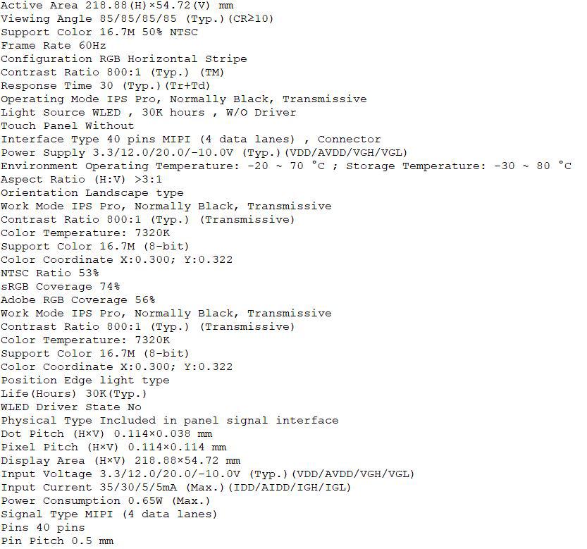

Hi,

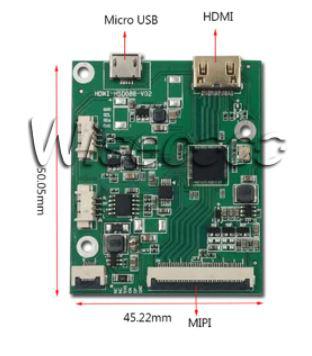

Does anyone have any experience with these? From a bit of research (not easy when all you get are amazon sites just selling) they are a Hannstar TFT LCD panel (1920x480) driven by an MIPI interface. From the Hannstar data sheet they look to be a 480 x 1920 display.
Most ebay/amazon sellers offer a HDMI to MIPI adapter PCB that also takes a micro-USB (presumably the USB port only powers the backlight), and seem to be targeting embedded PC devices (like a raspPi) which have a HDMI display adapter.
I am not up to speed on the MIPI interface other than it is looks like a fast differential variant of SPI or SQI (up to 4Gbps and 4 data lanes). Without ANY documented evidence either way, the LCD probably has no memory of its' own and relies entirely on the MIPI interface to feed it continuous data (ie: it has no frame buffer).
I'm thinking if it was coupled with a decent frame buffer chip (like the SSD1963 but better) it would make for a nice display that gets away from the ho-hum 16:9 displays that now seem to be on *everything*.
I am tempted to buy one and just have a probe - see those signals.
Cheers,
(PS: search ebay for "1920x480" or "HSD088IPW1" to see what they look like).

This is what I could find on it
it seems it uses a HDMI to MIPI interface board and the power is got from the USB connector
it's designed for use in car dashboards

I would like to know what part number that HDMI/MIPI conversion chip is. I could then look it up for some juicy hardware details! Sadly all the pictures I've seen of that adapter PCB are so poor there is no chance of getting a part number from them.

That is an interesting display indeed. A quick Google Search came up with this:
DataSheet
Hope it is of help.

Posted: 10:19am 22 Jan 2021
@Emandy
Yup, got that datasheet (but thanks anyway for posting as it will hopefully be of use to others).
@matherp
That presenter has a terrible accent! The presentation was quite good, although made by ST, naturally he only tells us that an ST part can do it and makes mention of no others.
He does mention the 'older style' "LTDC" (LCD TFT Display controller) chip, which is essentially what an SSD1963 is. However, apart from pushing the STM32 parts, makes no mention of what a dedicated MIPI/DSI/DPI/DBI part might be called. Full points for only pushing your own product, but of no real help. I would have liked a phrase I could search on!
An STM32 is a full micro, and what I want is a chip that incorporates a frame buffer (GRAM), with an interface to get data into it, and DSI port/s to drive a display. Guess I'll just have to start searching on random phrases...
... although one could just use an STM32 and write some code that implements a frame buffer, input interface & output interface...
But that's more damn software (and more damn software toolchains and device programmers). Doh!
Cheers,
MustardMan
Joined: 30/08/2019
Posts: 175
Posted: 10:20am 29 Jan 2021
An update... I will probably let this one fade away. Research over the last week has not been promising. A summary for those interested:
I was fairly interested in the STM microcontrollers with integrated DSI. Despite using a different toolchain to the PIC stuff I had, the Colour Maximite is designed around an STM part, and I would have to get into that sooner or later...
Of interest was the STM32F769/779 as that chip has a DSI host peripheral, and the CMM2 uses a STM32H743. Not too different. That datasheet refers to an application note that apparently specifically talked about the DSI peripheral: AN4860. Well, that was not that easy to find (I could not find it anywhere on the STM site, but maybe that's just me) and google was not too interested in helping out. I eventually found a copy after probably two or three hours of searching and following links to sites that promise everything and deliver nothing (except viruses). Anyway, it contains a *wealth* of information about DSI, and if you are into that, I recommend a read!
However, its bandwidth is fairly low (500Mbps x2 ports), and from what I could determine the display is a 4 port device at up to 1Gbps per port. It might be drivable, but the refresh might be too slow. I've ordered a couple just to play with, but I think it will be an exercise in futility.
