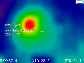

  Pilot352 said  If we do this, is there any recommendation on adding additional heat sinks?
I doubt if a heat sink is necessary. During the execution (>30x) of Peter's stress test, the CPU of my CMM2/400MHz/MMBasic 5.06.00 only reached ~40 degrees Celsius.
Edited 2021-01-27 03:40 by twofingers
