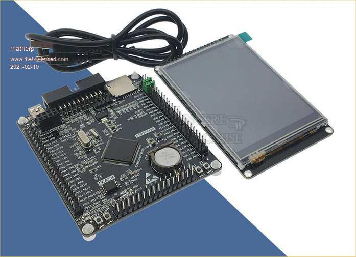

Please find attached new firmware for the ArmmiteF4. This includes various bug fixes that Geoff has included in recent MMBasic releases, some minor optimisations from the CMM2 and a bug fix for a memory corruption using sprite close.
ArmmiteF407.zip
Like all STM32 you can program the firmware directly over the USB connection see here and here for lots more information about programming and the ArmmiteF4 in general
For those that don't know about the ArmmiteF4, it is my favourite MMbasic port. A single board that has everything you need - USB serial port, RTC with battery, SDcard slot, TFT header. It runs faster than the MM+ and is much cheaper as a complete system. Lots of projects like Geoff's Super Clock, DDS signal generator, and boat computer are easy to port to the ArmmiteF4 with display and run superbly.
The matching display is 16-bit parallel and very fast
Buy the pair from here and many other vendors
Note there are lots of variants of STM32F407 development boards. You must buy the one pictured for the firmware to work.
The only downside is that there isn't currently a dedicated manual for the ArmmiteF4. To create one is just a cut and paste exercise so if anyone wants to volunteer I would be happy to provide word files and guidance.

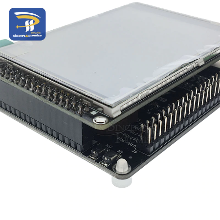

Does that display plug directly onto the board ?
my site
Quazee137
Joined: 07/08/2016
Posts: 603
Posted: 09:58pm 09 Feb 2021
Yes
Is that a certain ' brand ' or ?
Edited 2021-02-10 09:29 by hitsware2
my site
Posts: 3879
Posted: 12:06am 10 Feb 2021
  hitsware2 said  Neato .... Thank You ....
Not the "black pill", not other STM32F4 varieties. Search aliexpress for "STM32F407VET6". If you want the LCD, pick, a site which shows it in addition to the F4 board.
Like this. Matherp's site has a better price.
Edited 2021-02-10 10:08 by lizby

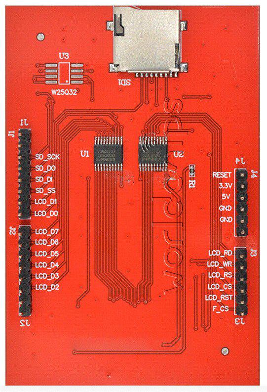

Better would be something like this

If you design a backpack I'll commit to getting the ILI9488 working. Be aware though that the display is slow: 480x320 16-bit is a lot of data over SPI
Excellent. I've ordered one of the "3.5" inch 480x320 TFT LCD Touch Screen Display Board For Arduino UNO R3 Mega2560" LCDs from here
Is the connection from the F4 LDC header straightforward?

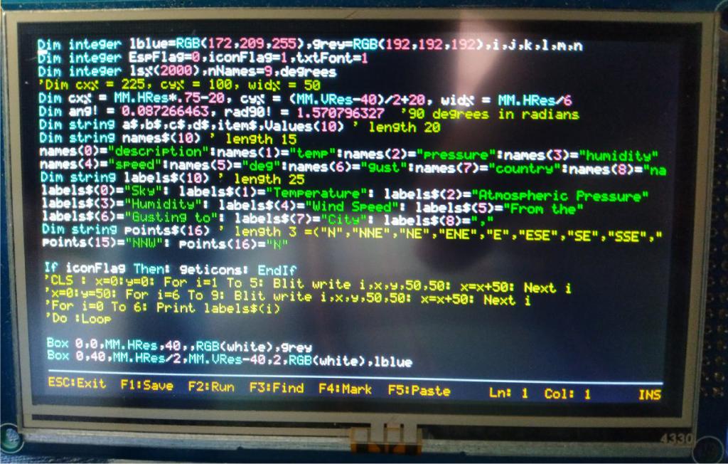

To me, 480x320 is adequate for running the editor with OPTION LCDPANEL CONSOLE--but if only one could be implemented, the 800x480 would be better, I guess--especially if you already have a driver working.
Can you post a picture of the editor on the 800x480 screen in CONSOLE mode?
