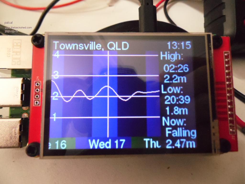

I bought a Pi3B+ to build a project from Silicon Chip July 2018, a Tide Chart.
Got the Pi all up and running, downloaded the software from SC, but it has to run on Python2. So I navigated to Preferences/Main Menu Editor/Programming and ticked Python2.7 . At first when I clicked the Raspberry and Programming and selected 2.7 it opened in a black screen like a terminal window. I rebooted and now it throws an error and wont open at all. How do I get to use 2.7 just like I can use Python3.

I tried to convert the code to Python 3 by taking the error messages one at a time. The first one was easy, remove parenthesis from all the print statements but I got lost when Import commands were throwing errors. I know not much about the Pi and even less about Python. Why SC printed an article that uses old software I don't know. The project gets the tide heights and times from the Weather Bureau and converts them into graphs that are displayed on the screen

I tried to convert the code to Python 3 by taking the error messages one at a time. The first one was easy, remove parenthesis from all the print statements but I got lost when Import commands were throwing errors. I know not much about the Pi and even less about Python. Why SC printed an article that uses old software I don't know. The project gets the tide heights and times from the Weather Bureau and converts them into graphs that are displayed on the screen (ILI9341).

Finally found out that Raspbian Stretch defaults to Python2 so I downloaded that.
I am finally getting somewhere the code runs and I have a UI on the screen.

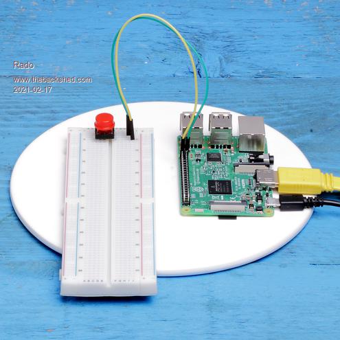

It's really simple:
https://www.quartoknows.com/page/raspberry-pi-shutdown-button

palcal
Joined: 12/10/2011
Posts: 2052
Posted: 08:49pm 17 Feb 2021
Thanks for the ideas. I'll try the Button and see how it goes.
