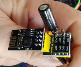

@lizby how do you powered the esp modules ?
Plasma
Posts: 3879
Posted: 05:24pm 28 Feb 2021
  Plasmamac said  @lizby how do you powered the esp modules ?
I used 3V3 directly off the CMM2 40-pin connector, with dupont wires running to an ESP-01 breakout module. I soldered 10K between 3V3 and CHPD, and a 1800uF 6.3V cap between 3V3 and 0V.
A smaller cap would probably work, and perhaps none (there's a tiny cap on the breakout board).
