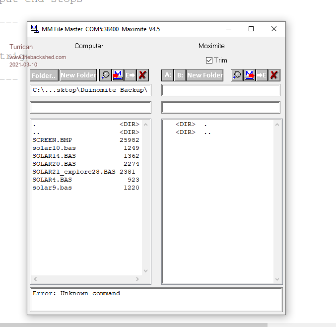

I use the Load and Run function in MMEdit to send my program to the Micromite but I am still a but puzzled on how to retrive the current program from the Micromite back to the MMeditor.

Turrican
Joined: 24/06/2019
Location: Sweden
Posts: 10
Posted: 08:35am 10 Mar 2021
/QUOTE]
It's the button in the middle
Yes, that is how I have tranfered files on my Duinomite but the Micromite Explore 28, afaik dont have a file system and can not save or load files. therefore there no file to transfer. I am new to the Micromites so I may be wrong. :)

Posts: 11870
Posted: 10:51am 10 Mar 2021
You need to set the correct protocol for the Micromite in the dropdown, far right of the top line. At the moment you seem to be set for the Maximite

Posts: 6115
Posted: 11:42am 10 Mar 2021
Hi Turrican,
I understand you started out with a maximite/duinomite platform, and you are trying to port that software to the micromite explore 28. Besides differences in MMbasic (what commands are supported) there are also differences in platform.
One difference between these 2 platforms is following:
Maximite
The maximite has a large of flash memory inside the chip itself. That flash memory is split between the MMBasic interpreter, and a file system (the A drive).
When you add a SD card to a maximite you this SD card shows up as a B drive.
Micromite
The micromite (especially the Explore28) does not have enough flash memory to create an A drive inside the chip. If you need file storage this must be added to the Explore 28 as separate hardware, and software. The Explore 28 itself can only hold it's own program in the chips memory (besides the MMBasic interpreter). The explore 28 mates very well with MMedit, where you have a good development environment, and MMedit takes care of uploading your program to the explore 28. The build in editor in the explore 28 can also be used, but then getting your program from and to the PC uses XMODEM or copy/paste from terminal screen using AUTOSAVE (F10).
I hope explains the differences in way of working with the 2 platforms.
