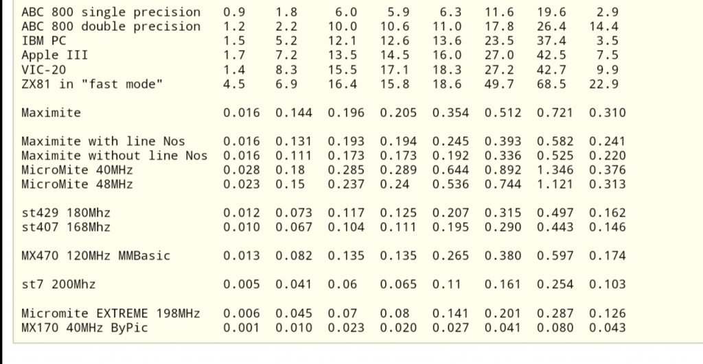

This series of benchmarks happened a while ago, to give you some idea:
CircuitGizmos
Joined: 08/09/2011
Posts: 1427
Posted: 11:20pm 25 Mar 2021
This was the first thread:
http://www.thebackshed.com/forum/ViewTopic.php?TID=4685&P=1
Edited 2021-03-26 09:20 by CircuitGizmos

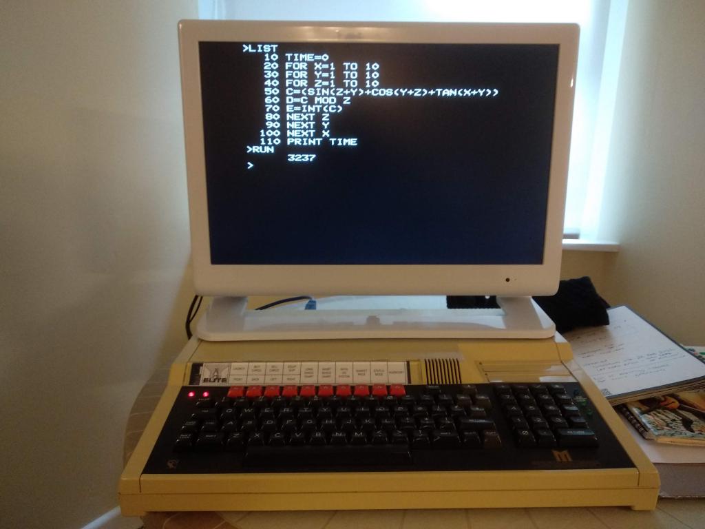

Hi Nimue,
Assuming you are still interested in the answer to your original question, my BBC Master 128 managed it in 32 seconds:
This goes down to 30 seconds if you use the "resident integer" variables, i.e. stick % after all the single variable integers.
I'm a little surprised it is over 4x faster than your Electron. I'm not an expert but it's a 65C12 processor (a souped up 6502) running at 2 MHz.

  thwill said  Hi Nimue,
With old Beebs the Rifa capacitors in the power supplys like to go pop, let out their magic smoke and spray goo over the motherboard, and with the Master the CMOS battery likes to spill over everything too. The Electron doesn't have the battery, but it may have the same problem with the capacitors. The "Acorn Computer and BBC Micro Enthusiasts" group on Facebook can advise you on how to keep it alive and give it some TLC. Mark Haysman @RetroClinic on that group is the main guru and the man to see for any bits.
Yes, still interested in the speed test -- thank you.
I have had the Elk apart -the power supply (transformer) is supplying 19-20V AC to the PSU.  The PSU is spitting out +/- 5V DC and passes through the 19-20V AC.
Will follow up yuor suggestions.
N
