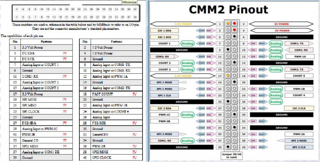

If it's been posted, I didn't note it. I'm looking for a chart or spreadsheet listing the GPIO pin names and/or numbers for the 20x2 40-pin GPIO connector. Something which supplements these:
I'm trying to replicate something like what I'm using for a GPIO PCB for the F4:
I have a vague recollection that something like this has been posted, but I can't find it.

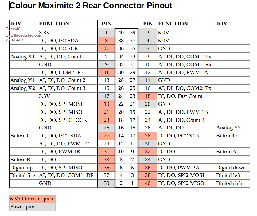

Posted: 03:12am 03 Apr 2021
I posted this during the discussion on joysticks. I can upload it as a doc or spreadsheet if it is of any use?

This is the master
const struct s_PinDef PinDef40[NBRPINS+1]={
       { NULL,  0, PUNUSED , NULL, 0},                                                         // pin 0
{ NULL,  0, PUNUSED , NULL, 0},                                                         // pin 1 3V3
{ NULL,  0, PUNUSED , NULL, 0},                                                         // pin 2 5V
       { GPIOB,  GPIO_PIN_9,  DIGITAL_IN | DIGITAL_OUT , NULL, 0},                             // pin 3 I2C-SDA
{ NULL,  0, PUNUSED , NULL, 0},                                                         // pin 4 5V
       { GPIOB,  GPIO_PIN_8,  DIGITAL_IN | DIGITAL_OUT , NULL, 0},                             // pin 5 I2C-SCK
       { NULL,  0, PUNUSED , NULL, 0},                                                         // pin 6 GND
       { GPIOC,  GPIO_PIN_1,  DIGITAL_IN | DIGITAL_OUT | ANALOG_IN , ADC1, ADC_CHANNEL_11},    // pin 7 COUNT1
{ GPIOA,  GPIO_PIN_2,  DIGITAL_IN | DIGITAL_OUT | ANALOG_IN , ADC2, ADC_CHANNEL_14},    // pin 8 COM1-TX
       { NULL,  0, PUNUSED , NULL, 0},                                                         // pin 9 GND
{ GPIOA,  GPIO_PIN_3,  DIGITAL_IN | DIGITAL_OUT | ANALOG_IN , ADC1, ADC_CHANNEL_15},    // pin 10 COM1-RX
       { GPIOH,  GPIO_PIN_14,  DIGITAL_IN | DIGITAL_OUT , NULL, 0},                            // pin 11 COM2-RX
{ GPIOA,  GPIO_PIN_6,  DIGITAL_IN | DIGITAL_OUT | ANALOG_IN , ADC2, ADC_CHANNEL_3},     // pin 12 PWM-1A
{ GPIOC,  GPIO_PIN_2,  DIGITAL_IN | DIGITAL_OUT | ANALOG_IN , ADC3, ADC_CHANNEL_0},     // pin 13 COUNT2,I2S-SDI
       { NULL,  0, PUNUSED , NULL, 0},                                                         // pin 14 GND
{ GPIOC,  GPIO_PIN_3,  DIGITAL_IN | DIGITAL_OUT | ANALOG_IN , ADC3, ADC_CHANNEL_1},     // pin 15 COUNT3,I2S-SDO
{ GPIOA,  GPIO_PIN_0,  DIGITAL_IN | DIGITAL_OUT | ANALOG_IN , ADC1, ADC_CHANNEL_16},    // pin 16 COM2-TX
       { NULL,  0, PUNUSED , NULL, 0},                                                         // pin 17 3V3
       { GPIOA,  GPIO_PIN_15,  DIGITAL_IN | DIGITAL_OUT , NULL, 0},                            // pin 18 COUNT5 - FAST
       { GPIOB,  GPIO_PIN_5,  DIGITAL_IN | DIGITAL_OUT , NULL, 0},                             // pin 19 SPI-OUT
       { NULL,  0, PUNUSED , NULL, 0},                                                         // pin 20 GND
       { GPIOB,  GPIO_PIN_4,  DIGITAL_IN | DIGITAL_OUT , NULL, 0},                             // pin 21 SPI-IN
       { GPIOA,  GPIO_PIN_7,  DIGITAL_IN | DIGITAL_OUT | ANALOG_IN , ADC1, ADC_CHANNEL_7},     // pin 22 PWM-1B
       { GPIOB,  GPIO_PIN_3,  DIGITAL_IN | DIGITAL_OUT , NULL, 0},                             // pin 23 SPI-CLK
{ GPIOC,  GPIO_PIN_4,  DIGITAL_IN | DIGITAL_OUT | ANALOG_IN , ADC1, ADC_CHANNEL_4},     // pin 24 COUNT4
       { NULL,  0, PUNUSED , NULL, 0},                                                         // pin 25 GND
{ GPIOC,  GPIO_PIN_5,  DIGITAL_IN | DIGITAL_OUT | ANALOG_IN , ADC2, ADC_CHANNEL_8},     // pin 26
       { GPIOB,  GPIO_PIN_7,  DIGITAL_IN | DIGITAL_OUT , NULL, 0},                             // pin 27 I2C2-SDA
       { GPIOH,  GPIO_PIN_11,  DIGITAL_IN | DIGITAL_OUT , NULL, 0},                            // pin 28 I2C2-SCK
{ GPIOB,  GPIO_PIN_0,  DIGITAL_IN | DIGITAL_OUT | ANALOG_IN , ADC2, ADC_CHANNEL_9},     // pin 29 PWM-1C
       { NULL,  0, PUNUSED , NULL, 0},                                                         // pin 30 GND
       { GPIOC,  GPIO_PIN_7,  DIGITAL_IN | DIGITAL_OUT , NULL, 0},                             // pin 31 PWM-2B
       { GPIOI,  GPIO_PIN_8,  DIGITAL_IN | DIGITAL_OUT , NULL, 0},                             // pin 32
       { GPIOI,  GPIO_PIN_3,  DIGITAL_IN | DIGITAL_OUT , NULL, 0},                             // pin 33
       { NULL,  0, PUNUSED , NULL, 0},                                                         // pin 34 GND
       { GPIOB,  GPIO_PIN_14,  DIGITAL_IN | DIGITAL_OUT , NULL, 0},                            // pin 35 SPI2-IN
       { GPIOC,  GPIO_PIN_6,  DIGITAL_IN | DIGITAL_OUT , NULL, 0},                             // pin 36 PWM-2A
       { GPIOA,  GPIO_PIN_1,  DIGITAL_IN | DIGITAL_OUT | ANALOG_IN , ADC1, ADC_CHANNEL_17},    // pin 37 COM1-DE
       { GPIOB,  GPIO_PIN_15,  DIGITAL_IN | DIGITAL_OUT , NULL, 0},                            // pin 38 SPI2-OUT
       { NULL,  0, PUNUSED , NULL, 0},                                                         // pin 39 GND
       { GPIOB,  GPIO_PIN_13,  DIGITAL_IN | DIGITAL_OUT , NULL, 0},                            // pin 40 SPI2-CLK
       { GPIOB,  GPIO_PIN_12,  DIGITAL_IN | DIGITAL_OUT , NULL, 0},                            // pin 41 IR
       { GPIOE,  GPIO_PIN_2,  DIGITAL_IN | DIGITAL_OUT , NULL, 0},                             // pin 42 DS18B20
       { GPIOB,  GPIO_PIN_11,  DIGITAL_IN | DIGITAL_OUT , NULL, 0},                            // pin 43 Nunchuck SDA
       { GPIOH,  GPIO_PIN_4,  DIGITAL_IN | DIGITAL_OUT | ANALOG_IN , ADC3, ADC_CHANNEL_15},    // pin 44 Nunchuck SCK

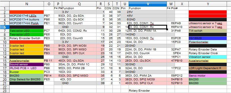

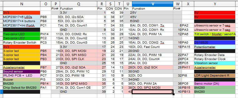

Posts: 3879
Posted: 12:19pm 03 Apr 2021
Thanks, Bill and Peter. I'm pretty sure I had something like Bill's posting in spreadsheet format, and that was what I used to produce the provisional F4 layout, but I can't find it. I2C, SPI, COM1 and COM2 are in the same place, but there were fewer ADC available on the F4, and I don't think I was able to get all the PWMs.
I'll use that as a template with Peter's master and will post the spreadsheet doc.

Posts: 3879
Posted: 05:35pm 03 Apr 2021
Here's a shot of the spreadsheet with the pin names. Since I've been working with the F4, I had forgotten that the CMM2 pin numbers are the same as the 20x2 connector pin numbers.
