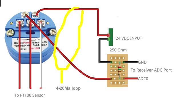

try the PT100 to 4-20Ma. change the 250Ohm to match the ADC max.
I have seen a few job sites where they used 12VDC. Not sure if they made
any other changes.
 4-20Ma is Great in noise environments.

A lot of electricity generation systems (also noisy) use 4-20mA signals for engine and alternator temps (and you can get 4-20mA current transformers too - you'd think that was asking for trouble!) so that's also well worth considering.

I've used 4-20 loops before (on the Explore 100, implemented using the 'click' range of boards) and have been impressed with their performance in harsh (electrical) environments. The downside - they are expensive and require non-trivial extras to work.

I wonder if this 4-20mA would work with the MCP? I've not attempted it. :)
+------+-------+--------RES-------+----- +12
zen5v  cap    MCP      |  \_____|/
|      |       |      -|- /     |\ npn
|      |       |                  RES1
                                        RES2
                                         +---- 0v
The op amp would need to be a rail-rail 5v one. RES1 would be 75R to give 20mA at 100C (I think) and RES2 would be 165R to give 3.3v out at 100C. These numbers could be twiddled, of course.
