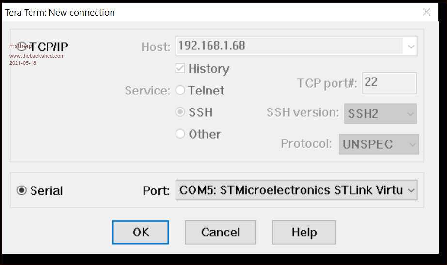

After doing this, i cannot connect to Serial console (USB and Pin A1/A2)?
Posts: 11870
Posted: 08:38am 18 May 2021
Just checked and that is the latest version and works fine for me. Do you see the ST-LINK serial port? That is the console connection when the firmware is loaded.
If not you may need to install the driver. NB speed is 38400

Ok Guys,
thank you for the Help. Now it works. The wrong baudrate was the Problem.
