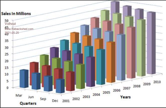

To me it is not entirely clear what you want to establish. In your excel sheet I see no Z axis, only linear conversions of X and Y.
If you need to represent 3 dimensional data in excel, excel has graph formats for it.
If you want to represent 3 dimensional data in MMBasic, you'll have to do some conversion like :
Xscreen = k1*Xdata + k2*Ydata + k3*Zdata
Yscreen = k4*Xdata + k5*Ydata + k6*Zdata
For fancier graphs like the Excel graphs, there is more calculation required.

Yeah, I mention in the first paragraph that I'm only showing the z-axis as a number next to each plotted point.  It's a simplification, but is adequate to my purposes.  I won't be doing any graphing except to plot points and maybe draw some lines connecting them.  Once I understand the 3d system in MMBasic better I might go back and do something that's actually 3D.  (I'm still learning the differences between MMBasic and all the other BASICs I used to play with back in the day.)
I only used LibreOffice Calc to help me work out the equations for translating the axes for display in the space defined for it.  (I warned that it might not make sense to anyone but me...)  The general equations developed from my tinkerings was what I was looking for feedback on, mainly seeking a better way to accomplish derivation than the admittedly "brute force" method I've employed here.
The thing that had me trippin' the hardest was the Y-axis, since in graphics space it is inverted (or rotated 180 degrees) from the usual Cartesian Y-axis, but I think I noodled out how to do that without resorting to any Linear Algebra.
