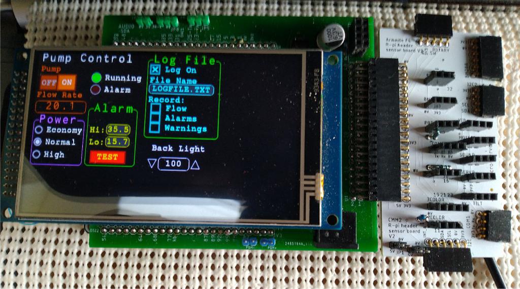

Picaxe is a great chip, but getting a large-screen display with graphics is difficult unless you use the pricy Nextion displays.
Here's an example of an ARMMite F4 with hat PCB, 800x480 display, and 2x20 breakout PCB for controlling pins (you can also use flying wires):
Details and links to PCB gerber files at Armmite F4 on Fruit of the shed (See "Boards for 2x20 40-pin pi-type connector", "Some LCDs" (and "LCD Adaptors" if you want a display bigger than the 320x240 one).)
For a 7" or larger display, BigMik's F4 PCB pointed to by tinine might be the best option.

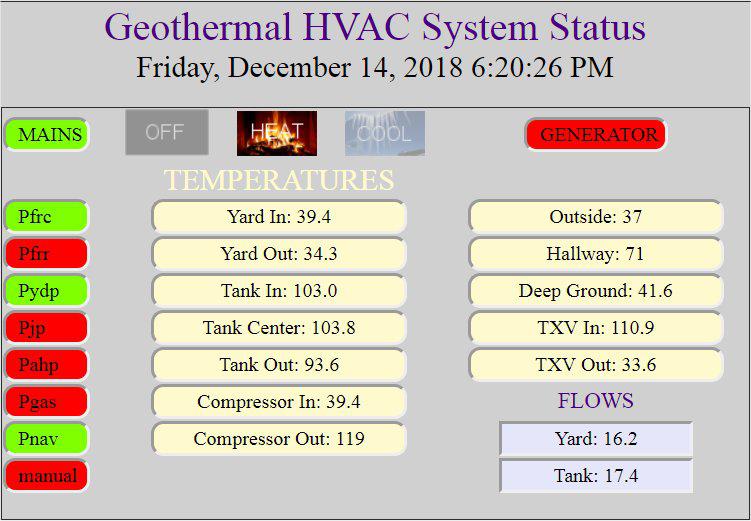

There's a picture of the prototype in this fairly long thread on the build here

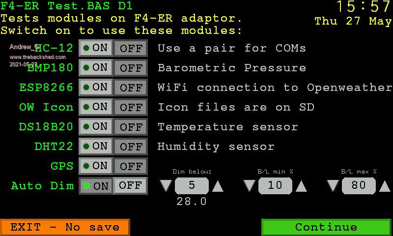

Roger,
This a relatively easy menu created on an Eastrising 800x480 LCD.
It is using BigMik's F4-ER adapter to an F4 running MMBasic.
In this case it just turns on modules connected to the F4 - but they could be relays, motors or whatever.

  Andrew_G said  Roger,
Thanks Andrew.
So you wrote the script for the display example you showed, or are there libraries of code to choose from and modify etc.
  Quote  In this case it just turns on modules connected to the F4 - but they could be relays, motors or whatever.
Temperature in this case is provided by a DS18B20, a DH22 or the internet via an ESP8266.
It automatically dims the LCD when the Light Dependent Resistor reading, ie "Dim Below", drops below 5 (it is currently 28.0) it will dim to 10% and the "Bright" value is 80% - all adjustable by MMBasic's GUI controls on the menu. The settings can be saved or abandoned.
