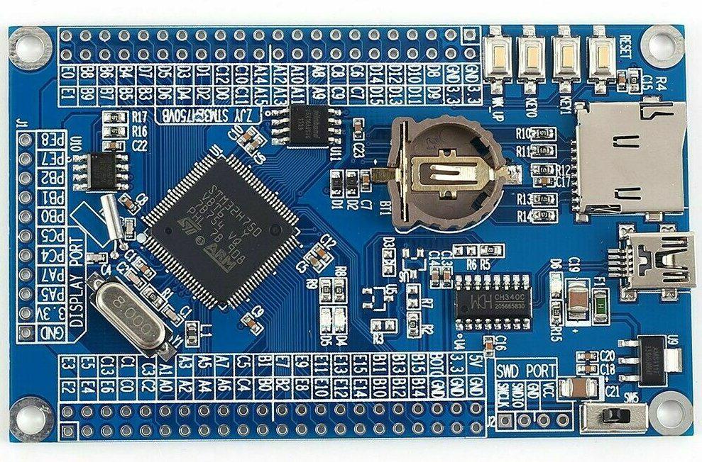

What "ready out of box" boards can be used for ARMmite H7?
1. The original NUCLEO-H743ZI board is no longer manufactured. Is NUCLEO-H743ZI2 compatible with firmware?
2. Any other cheap boards available?
Posts: 11673
Posted: 03:03pm 02 Jun 2021
  Quote  Is NUCLEO-H743ZI2 compatible with firmware?
Yes, search previous threads for links that need setting/removing
  Quote  Any other cheap boards available?
Not as far as I am aware
Edited 2021-06-03 01:03 by matherp
flasherror
Joined: 07/01/2019
Posts: 159
Posted: 04:38pm 02 Jun 2021
  matherp said  Yes, search previous threads for links that need setting/removing
Thanks for confirming.
Is the most recent Armmite H7 manual the one at https://www.thebackshed.com/forum/uploads/matherp/2019-06-25_212755_Armmite_H7_Manual.pdf ?
I came across this board while searching Ebay:
"STM32H750VBT6 Development Board ARM STM32H7"
I'm not sure if it is compatible but it has Battery, MicroSD, CH340, and a few keys, plus nice pin labels on PCB:
Not quite as cheap as F4 boards though. Might not have enough flash for MMBasic?
Edited 2021-06-03 02:59 by flasherror
Posts: 4357
Posted: 11:18am 04 Jun 2021
It will need EXACTLY the same CPU and even then you MUST check EVERY pin is used in the same (or a compatible) way.
Or just get the board known to work.
Did I mention EXACTLY... oh yes.
Edited 2021-06-04 21:19 by JohnS

  CaptainBoing said  and sort that bleedin' crystal out! dreadful
Photo from ebay, not my board.
Posts: 4357
Posted: 04:01pm 04 Jun 2021
Bearing in mind what I posted, that board is not suitable at all, crystal or not.
