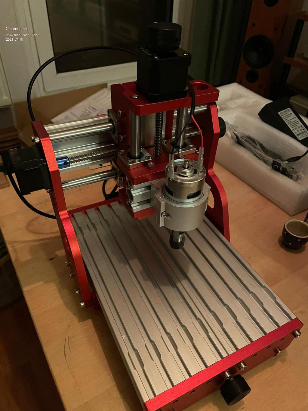

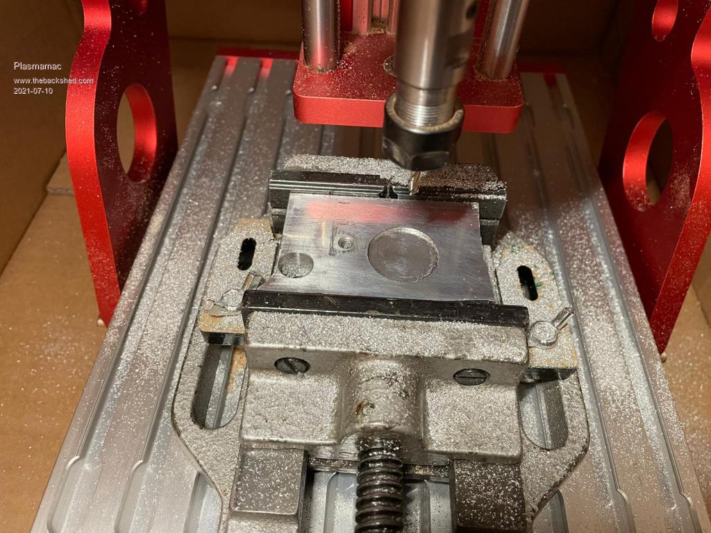

I bought a CNC 1310 for creating Pcb.
Plasma
Posts: 3879
Posted: 04:19pm 09 Jul 2021
  Plasmamac said  I bought a CNC 1310 for creating Pcb.
How has it worked? Do you have pics of output--and of the machine?

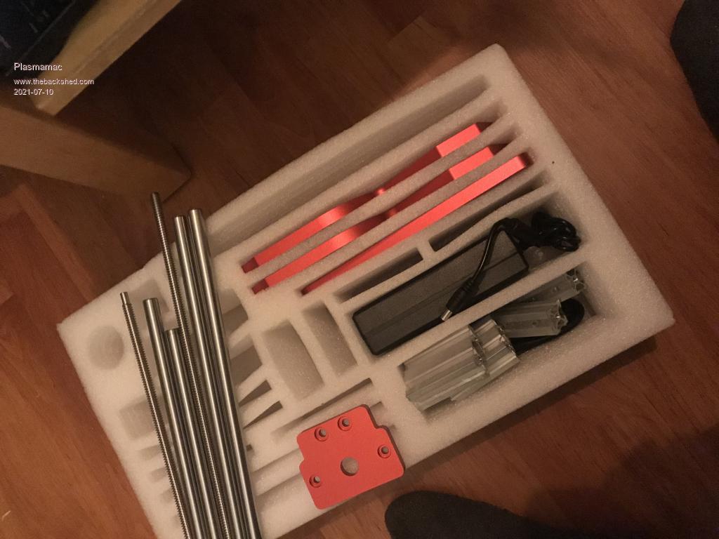

AndrewG and myself have both bought these and they arrived last week.
The day after I ordered it a `1 day special' came out for $165AU posted..  Grrrrr.
I dont think Andrew has built his yet but I have built mine and I must say it is not an easy build.
I started life as a toolmaker and this was still a challenge, but then Hey, that is half of the fun isnt it?
Despite my best efforts on making sure every thing was aligned as accurately as I could expect I still have a 0.7mm drop on the X axis over 200mm so I need to adjust the horizontal gantry on one side.
I believe that the software can take this into account but I haven't got that far yet and I still want to get it as accurate as I can any way (it must be the Virgo in me)
I have done a couple of the sample cuts and I must say I am very impressed so far with it. I will post a picture when I am back on my PC.

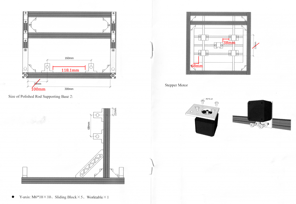

OK what you get.
A lousy instruction manual with incorrect measurements (i believe it was for a smaller model that they upsized but forgot to update, I will post that information later as well)
The instructions show what I believe is a one piece table but it is in fact a two pice that has to be joined by two strips of aluminium (seems quite effective but are not mentioned in the manual) but once again the measurements for the bearing mounts are out (no doubt due to a different table to the drawing) you have to improvise I will try to add pictures.
The mounting plates have holes drilled for the M3 screws but these are SUPER tight the screws have to be forcibly screwed into the plates and then screwed into the motors, they are tight but can be screwed in with some effort
A proper collet chuck is supplied instead of the joiner shown in the photos (a real bonus IMHO)
5 bits are supplied  but they are all the same very sharp angled (I guess a 10-15degree point) good for engraving.
A cheap 24V 4A Power brick of dubious safety, I have a claim on Banggood for this read later
An equally dubious US to AU plug adapter (the brick is fitted with a US plug)
The 3 motor cables are all the same length with the one for the Y axis too short for use (it would have to run under the table to actually fit but then would limit the travel of the table, the X axis length is OK the Z is way too long, I cut about 20cm (8") out of the Z axis cable and extended the Y axis with it, Much happier now, I think all cables are OK after that fix.
There are no limit switches fitted and YES I drove the unit beyond its travel range (Jams and stepper motor complains) This is a MUST to fit limit switches, I am still waiting for mine to arrive.
The reason I drove the table to the ends was it is difficult to conceive (not being experienced with these things is is the direction the way the table is to move or the way the spindle is to move (It is the spindle direction)
The supplied linear bearings are rough (Rough as guts is the Aussie technical term) these will need lubrication on a regular basis, I would prefer better bearings but I have no idea where to buy them from (without getting equally bad ones) however it doesn't seem to affect the steppers ability to drive the axis'.
The software needs to be configured for direction of the axis, This is easy and I have a table I will upload later just enter a command like $3=x (where x=1-9) with inverting one or two of the axis directions.
The Power brick.. Hmm for a 100w 24V 4A unit the first thing I noticed was its weight (or lack of it) is is very light, I plugged it in and it does deliver 24Vdc.. Ok but when used with the machine it drives the 3 axis perfectly fine but to start the motor on maximum (It says 1000 in the software but I suspect this is NOT RPM but some other figure) the motor starts to spin then stops then starts then stops continuously.. If I start at 700 then it spins fine and I can crank it up to 1000 and it will maintain the level. I made a cable from my bench power supply and it has no problems at starting at 1000 so it is the power brick that is at fault. I have made a claim on Banggood but as I dont want another suspect brick I have ordered a properly rated 24Vdc `caged'  power supply from Mouser (costs about $24AU) it is also available from element14.

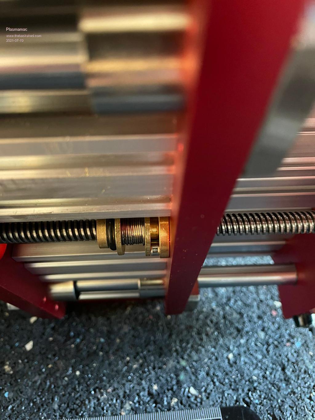

Plasmamac
Joined: 31/01/2019
Posts: 620
Posted: 03:01am 10 Jul 2021
Plasma
Posts: 3879
Posted: 10:45am 10 Jul 2021
Thanks for the pics. Looks sweet.

@lizby : beware you cnc is full of cheap plastic. The red one is full alu!
Plasma

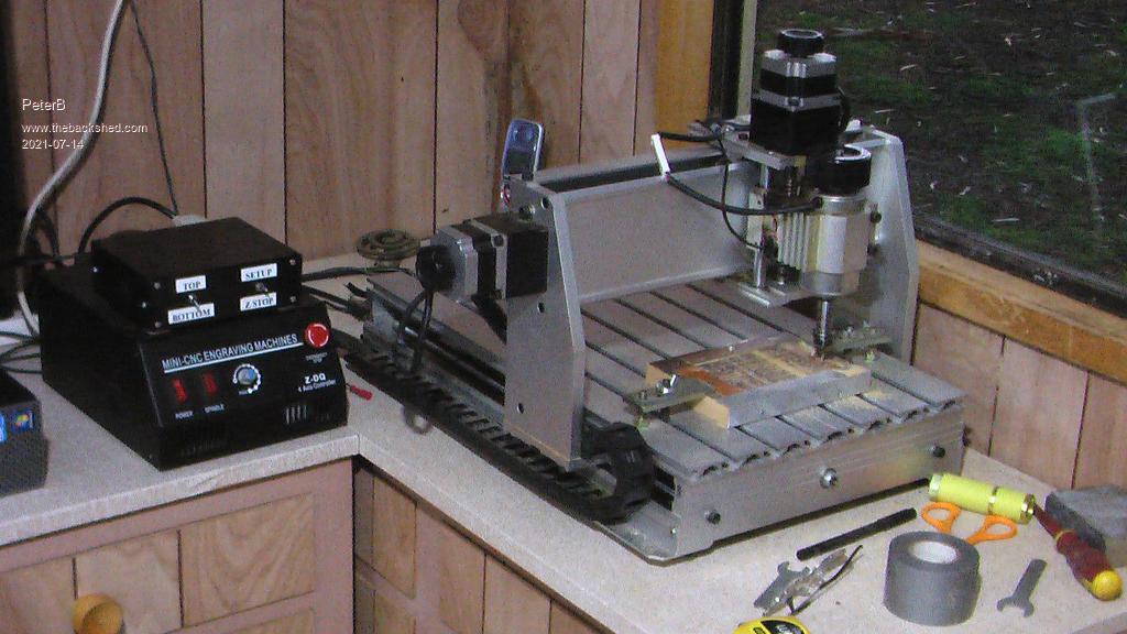

Posted: 05:14am 11 Jul 2021
Just my two cents worth. I purchased a 3018 router (300mmX180mm capacity) around three years ago and IIRC is cost around AU$350 at the time.
My prime aim was to have a router for prototype boards and this unit did provide useful education with CNC & PCB prototyping.
The controller was the first component to fail as one of the cpu io pins going to the servo driver died. I chose a replacement controller with a probe sense pin as the original did not have one and I had to direct solder a wire to the CPU to get
access to the pin and the probe function is necessary for PCB etching. The second failure was that the unit developed too much backlash on the worm screws and movement of the plastic Z axis mechanism with flexing of the two horizontal guide bars.
I purchased a 1610 size unit hoping that there would be less flex in the shorter guide and screw lengths but this unit like the previous was limited with the motor power and lack of rotation speed. I both cases I felt that these units are
not substantial enough to be reliable at metal routing.
My next resort was to build my own unit with more strength, larger capacity and more power. I started using a Dremel style router at 150W 240V with heavy duty guide rails and ball/screw drives from the servos to eliminate backlash error.
I have recently upgraded the motor to a 500w 110V type and find I have more flexibility and power for metal routing.

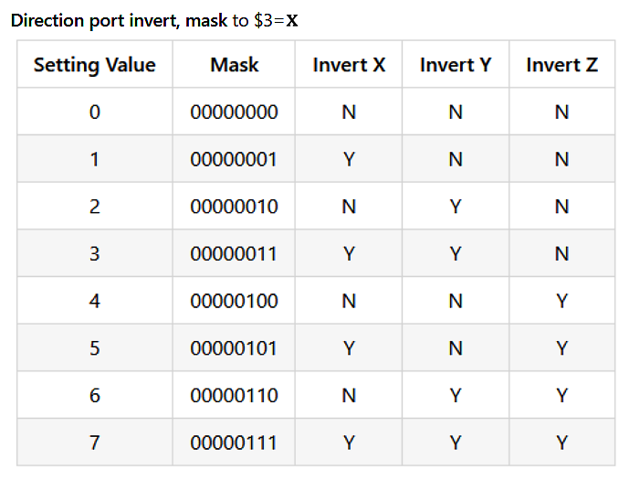

Posts: 2981
Posted: 05:30am 11 Jul 2021
At Plasmamac,
That is a very decent looking CNC you have there.
The 3018 is no where near that one.
Here are some `corrections' I did to the so called manual.
I suspect the document was originally for a smaller unit.
When I finished my unit one of the Axis (Y I think, I can't remember) were inverted direction. but here is a table to show the commands to adjust direction.
It is fairly self explanatory. just enter at the prompt  $3=x where x is the value from the table. This is a one off change but I think it adjusts the software NOT the cnc.
I cocked it up when I first did it so I did a $3=0 followed by the command I needed.
