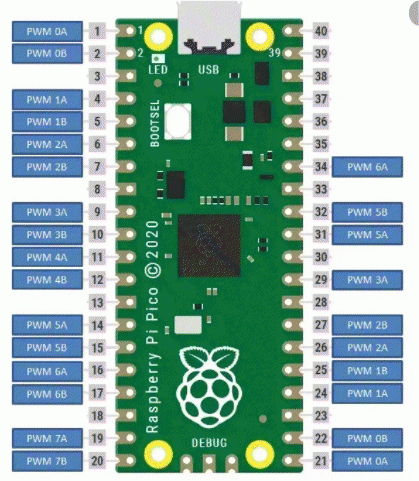

Posts: 3833
Posted: 08:32pm 16 Jul 2021
Ah, thanks. I missed that configuration. Does that imply that pin 16 is not available as DOUT or DIN if pin 17 is configured as PWM?
Posts: 3833
Posted: 11:26pm 16 Jul 2021
  lizby said  Does that imply that pin 16 is not available as DOUT or DIN if pin 17 is configured as PWM?
So the answer is "yes".

My immediate problem is that I've allocated pin 16 for SPI2 MISO. Some head-scratching is in order.
By the way, does this accurately display what's available in the way of PWM?
Edited 2021-07-17 10:15 by lizby
Posts: 8981
Posted: 06:16am 17 Jul 2021
That agrees with the Micropython book, so I assume it does. :)
