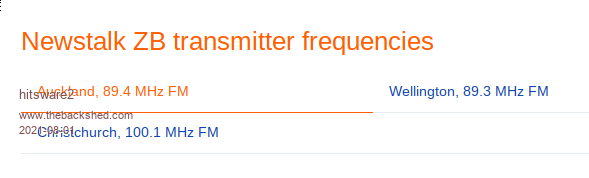

hitsware2

Posts: 10039
Posted: 05:52am 01 Aug 2021
@ hitsware: Newstalk ZB is only available on AM in my area(with the crappy sound quality), not on any FM frequency.  This is why I am trying to transmit locally on an FM frequency.
