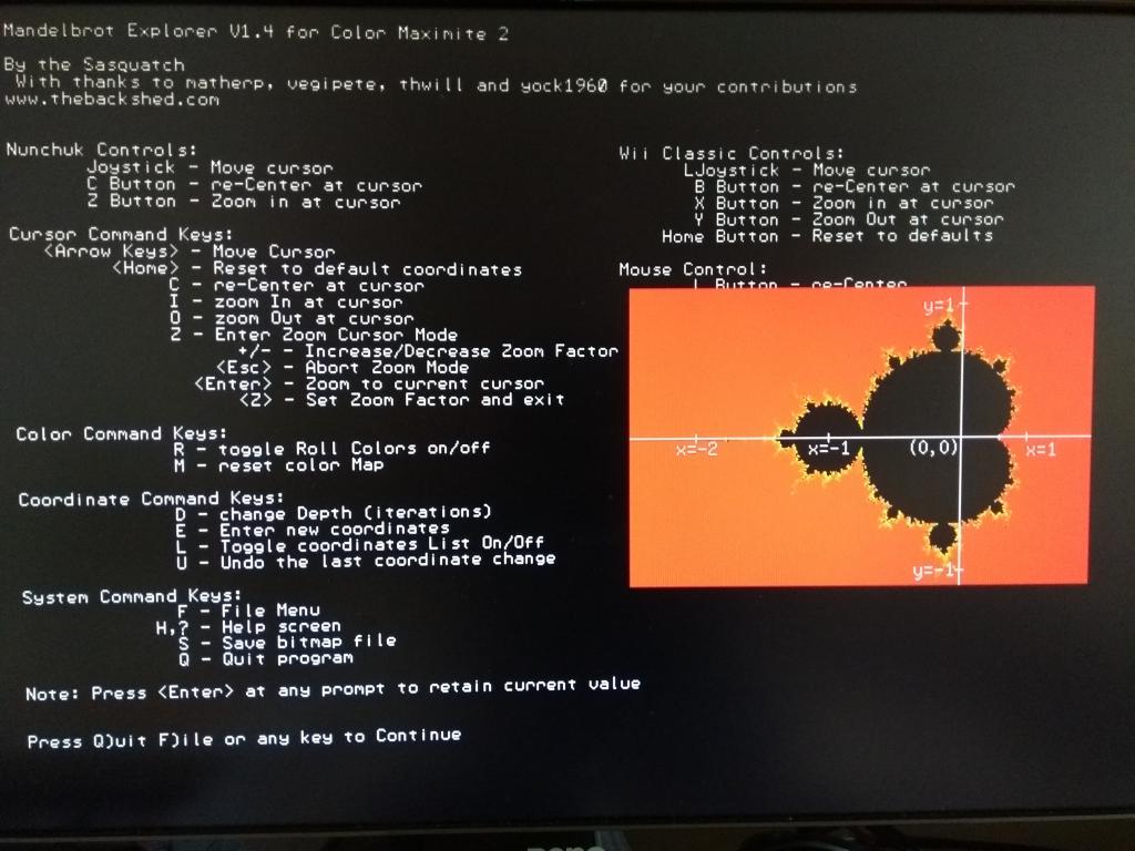

Hi folks,
I'm just doing a fix or two to "The Welcome Tape" to ensure compatibility with the upcoming 5.07.01 firmware.
I don't supposed there is anyone running 5.07.00 who has a copy of "The Welcome Tape 1.0.0" and could run up the "Mandelbrot Explorer" program and post a screen-shot (or even blury photo) of the Intro/Help page ? My CMM2's are all now running the RC1 firmware and I'm strapped for time and could do without having to wind one of them back.
TimD

Hi Tom,
Blurry photo?  Challenge accepted.  Hope this helps...
Thanks for your continuing efforts with the Welcome Tape and CMM2 generally
- Tim
Posts: 4398
Posted: 04:04pm 16 Aug 2021
Thank you Tim, that confirms my suspicion that the image hiding the Mouse Control instructions was a pre-existing issue and not new for 5.07.01. I guess I should add it to my bug list.

- Updated "Mandelbrot Explorer" to version 1.4.1
  - fixed bug on help/intro screen where image partially covered the
    instructions for using the mouse.
  - updated mouse support; if OPTION MOUSE is set then PS/2 or Hobbytronics
    mouse should work as configured.
  - updated so that {Esc} and {B} keys now return user to the help/intro screen
Edited 2021-08-17 08:11 by thwill
