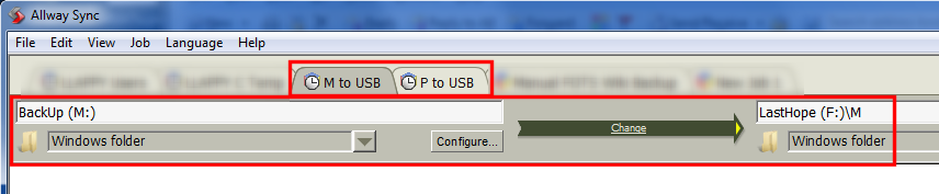

My advice on this (and it's what I advise others as it is really cheap and simple) is to do a periodic backup (weekly) to a single USB disk.
I have a 16Tb Drobo array but only about 3TB of actually "must not lose" stuff. I have a single 4TB USB disk which gets to be the recipient of that and spends nearly all it's time in power-save.
My advice is it's like insurance, don't see it as a waste of money, see it that if you never need it be happy.
so here are the two NAS disks (the drobo reports the whole array for both disks - a quirk) and the single USB3 disk that as you can see is appropriately named "Last Hope"

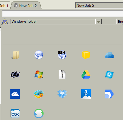

then using Allway Sync (excellent backup software) with the two backup jobs to simply replicate the entire structures (i.e. new/modify/delete are propagated) to two folders on last hope
Every-so-often I outgrow the single disk but they are so cheap that by the time that happens I simply change the mech for around GBP70, last time was 2 years ago and before that probably 3.
I have had disks fail in the array and it did carry on fine while it rebuilt onto the new member, but that "Russian Doll" failure is always on my mind when the lights are all flashing yellow
Of course none of this matters if the office burns down - I do have a Google Drive where I backup *REALLY* important stuff manually. Allway sync does have options for various cloud storage packages as well.
