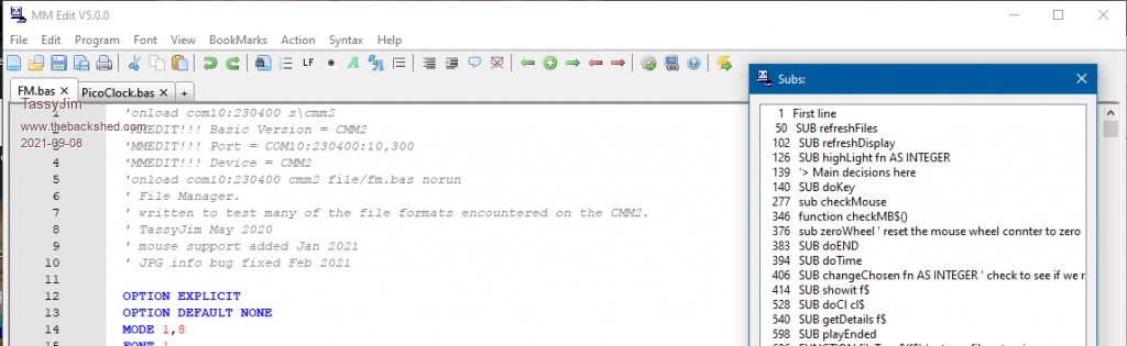

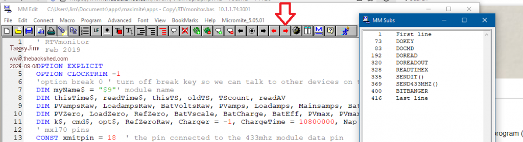

Just wondering if there was a way of listing the subroutine & function names etc in MM Edit in order as they appear in the program (along with the line numbers).
"Report Variable Usage" is great but lists stuff in alphabetical order.

Click on the red right arrow without any name selected and the pick-list appears.
V5 will also allow you to list all places the sub is used,across multiple files, but that is a few weeks away...

That will do it. Easy when you know how. Sort of ignored those two red arrows.
