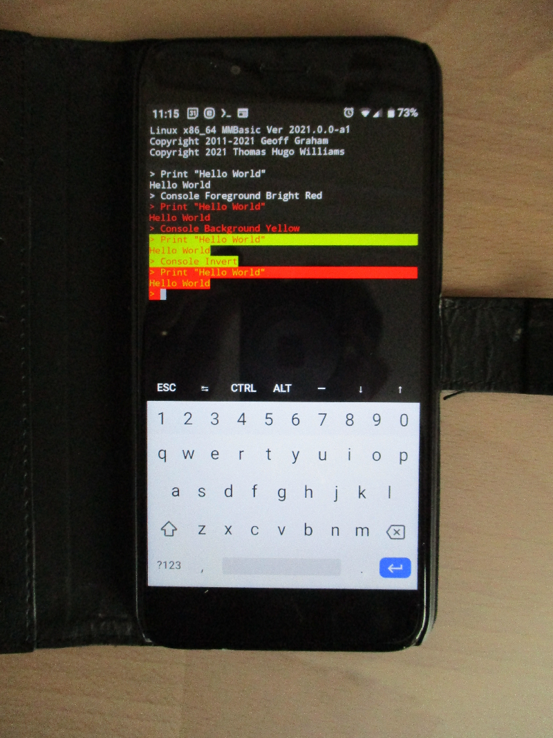

Not something I'm actively working on but in an idle 30 minutes this morning:
MMBasic is running natively on the phone (I'm not cheating by logging into a Linux box). Terminal emulation is provided by the Termux app.
Whilst I can run commands at the command line it won't list or run programs "in flash" at the moment. I don't expect it will be difficult to flush out the issue when I come back to it ... perhaps some bad pointer cast somewhere.

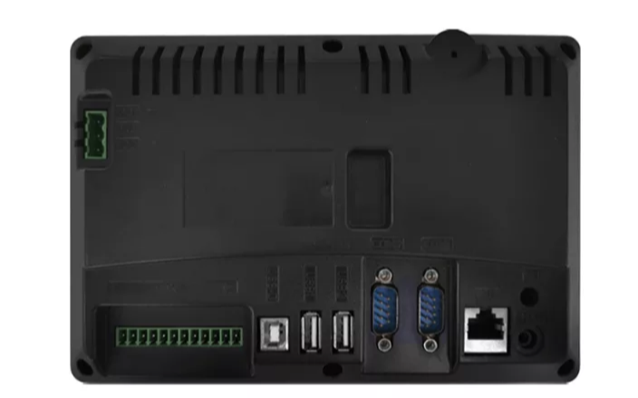

Posts: 6112
Posted: 07:57pm 11 Sep 2021
All these backpacks that are designed around PIC and STM32 chips running MMBasic are basically targetting this product. USB (keyb+mouse and terminal), serial (2x), ethernet, and discrete IO. Most likely 24V in / relay out. This is just perfect.
