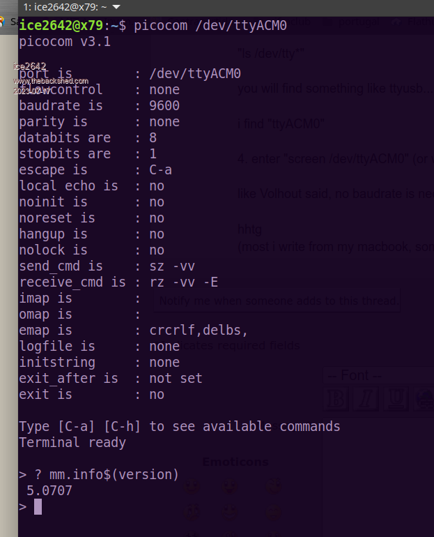

am i Right, that you ask for a terminalemulator for Linux/MacOS?
If this is the case, you can use SCREEN:
screen /dev/<console_port> 115200
Greetings
atmega8

There are a lot of different Linux distributions and they all have their quirks.
* No driver is required on Linux
* Raspberry Pi OS adds the regular 'pi' user to the 'dialout' group automatically: Debian and Ubuntu may not. You do want to be part of the dialout group, as it gives you access to the serial ports without elevated privileges
* Some distros include/start modemmanager by default, and it is a pain. Raspberry Pi OS doesn't, and I machine I've installed Ubuntu 21.04 on doesn't, but older Ubuntu machines did
* If the Raspberry Pi Pico is the only type of its kind attached to a Linux computer, it will be attached on the port /dev/ttyACM0
* If there are several USB devices like certain Arduinos, MicroPython/CircuitPython boards and alternative input controllers, finding the port can be a little more complicated as it won't always show up on the same port. If you've just plugged the Raspberry Pi Pico in, the command dmesg | tail -20 should include something like this:
[779122.426847] usb 3-13.2: New USB device found, idVendor=2e8a, idProduct=000a,
bcdDevice= 1.00
[779122.426850] usb 3-13.2: New USB device strings: Mfr=1, Product=2, SerialNumb
er=3
[779122.426851] usb 3-13.2: Product: Pico
[779122.426852] usb 3-13.2: Manufacturer: Raspberry Pi
[779122.426853] usb 3-13.2: SerialNumber: 000000000000
[779122.436940] cdc_acm 3-13.2:1.0: ttyACM2: USB ACM device
Your exact numbers will be different, but the string before 'Product: Pico' should match the line following that says ttyACMx: USB ACM device. In this case, the Raspberry Pi Pico is at /dev/ttyACM2. In every case, you'll see the idVendor=2e8a, idProduct=000a listed for the Raspberry Pi Pico.
If you want a serial port address that won't change, this command will show all the Raspberry Pi Picos hanging off the USB serial device:
ls /dev/serial/by-id/usb-Raspberry_Pi_Pico*
/dev/serial/by-id/usb-Raspberry_Pi_Pico_000000000000-if00
For now, all Raspberry Pi Picos running mmbasic will appear at /dev/serial/by-id/usb-Raspberry_Pi_Pico_000000000000-if00 . In the future, that string of zeroes may (should, please: it helps to have a unique board identifier, which you can get from the flash chip)
change to something unique.
For a terminal program, minicom works. Install it (+ xmodem support) on Debian-based systems (incl Raspberry Pi OS and Ubuntu) using:
sudo apt install minicom lrzsz
then run it with
minicom --device /dev/ttyACM0 --color=on
This should connect directly with mmbasic's REPL.Make sure you use the right device name.

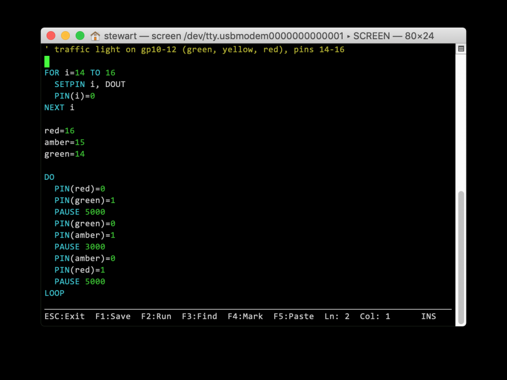

I don't know much about Macs, but CircuitPython's docs suggest the Raspberry Pi Pico will appear as something like /dev/tty.usbmodem*. No driver required.

I've just had the chance to run a Pico with mmbasic installed on a Mac.
- the port will be of the form /dev/tty.usbmodem*, as in /dev/tty.usbmodem0000000000001
- no driver is required
- Mac OS Terminal is already a full VTxxx emulator, and Mac OS comes with screen installed. You can run it like this:
screen /dev/tty.usbmodem0000000000001
(no serial rate required)
It seems to support the editor:

In debian you can use picocom too to connect your pico to PC
sudo apt install picocom
I believe in raspberry pixel repository you can found this program, in amd64 Debian have it.
Best regards,
