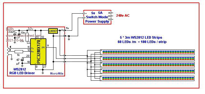

Hi  I have addressed up to 300 WS2812 using a pic32MX170 using peter's csub to handle the comms timing which is critical with these LEDs.
The video below is of 120 LED for a waterfall star for my christmas lights.
I you post the program if required.
120 WS2812
256 ws2812 leds and a pic32mx170 - scrolling display
265 ws2812
sorry about the focus.
Bill
Edited 2021-10-03 12:54 by Bill.b

The waterfall star program and schematic.
  'Test Program for ws2812 RGB LED Strip
 'Waterfall Star  180 LEDs per strip by 5 strips
'Bill Brown  oct 2018  CSub - Peter Mather
 Option autorun on
 Option DEFAULT NONE
 CPU 48
' Option EXPLICIT  Randomize Timer
 Dim integer count, count1, rndnum, loopcnt, indexcount,count2, count3,cyclecount,i
 const LED_PIN = 9   ' pin to connect to the data-in on the WS2812B module
const NUMLEDS = 180' number of LEDs in the WS2812B module chain
setpin LED_PIN,DOUT
 Dim integer buffer(580)
 DIM INTEGER colours(NUMLEDS-1)
 Dim integer red1, red
 Dim integer green1, green
 Dim integer blue1, blue
 Dim integer colour1(600)
PIN(LED_PIN) = 0  ' set LED_PIN low to begin
 'SPI open 5000000, 3,8
 do
  For count = 0 To 540  'Reset all LED to OFF
   buffer(count) = 00
 Next count
 sendled
   for indexcount = 1 to 10
    For loopcnt = 0 To 539
         Read  buffer(loopcnt)
       Next loopcnt
  For count2 = 1 To 180       'rotate data in buffer array
    For loopcnt = 540 To 0 Step -3
       buffer(loopcnt + 3) = buffer(loopcnt)
       buffer(loopcnt + 4) = buffer(loopcnt + 1)
       buffer(loopcnt + 5) = buffer(loopcnt + 2)
        'pause 100
 Next loopcnt
       buffer(2) = buffer(539)
       buffer(1) = buffer(538)
       buffer(0) = buffer(537)
       sendLED    'send buffer data to LEDs
   Next count2
   next indexcount
Restore
randomdata
sub randomdata
       for count1 = 1 to 152        'repeat random lights 150 times
     for count = 0 to 5
       rndnum = Int(RND()*540)+1           'Set array size and set data - Number of LEDs * 3
       Buffer(rndnum) = count * 20 and 20  'Set Brightness of LED
     next count
     sendLED
     pause 100
   next count1
   sendLED
   pause 900
   endif
   end sub
sub sendLED
count = 0
    for i = 0 to 540 step 3
         WS2812.setcolour count, buffer(i), buffer(i+1), buffer(i+2)
        count = count + 1
         if count > 179 then
           count = 0
         endif
     next i
 WS2812.Pulses(NUMLEDS,LED_PIN,colours())
end sub
sub WS2812.setcolour(led as integer, greenness as integer, redness as integer, blueness as integer)
 colours(led) = ((greenness and &HFF)<<16) + ((redness and &HFF)<<8) + (blueness and &HFF)
end sub

I use Big Micks MuP V3 boards for all my LED displays.
