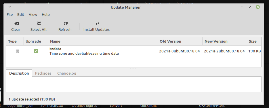

Howdy.
One thing I have got REALLY sick of in Linux Mint, is the CONSTANT nagging for the password - "Authentication is required to perform this action." - any time the system wants to apply updates or you want to install any new software.
I wouldn't mind so much if it only asked once, but it asks for the bloody password for EVERY SINGLE PACKAGE it needs to install, and so I find I have to enter the password up to ten times for a larger package install that needs to install dependencies to make it work, with all the freakin' dependencies also prompting for the bloody password.
This is WORSE then the Windoze nagging for the same reasons.
Is there a way I can turn this OFF?
It's driving me crazy and making me not like Mint because of it.

IIRC you can select "Update All" or something like that. You are only asked once then, no matter how many packages are updated. It's a long time since I last used Mint, but I'm sure it was like this last time I used it. Turning the check off completely isn't a great idea for security reasons.

are you updating using the 'Update Manager' (GUI) that is accessed using the small shield icon in the system tray?
with Linux Mint XFCE, versions 19 and 20, the Update Manager only asks me for the password once at the beginning of a series of updates.
for things typed in at a command prompt, linux seems to remember once the password has been typed in for something like the next 30 seconds or so.

That's the one! - Run Update Manager & click "Select All" then "Install Updates".

The Update manager (or package installer) should *not* ask you every time for the sudoer pass - only when you click on "install" should you be asked to enter a password, only once; the rest of the process should use the same provided credential.
Could you explain in a little more detail what you're doing?

Mint is very user friendly. IIRC you just click on the little shield icon at the bottom right of the desktop to start the update manager. I seem to remember that its colour changes depending on whether or not updates are waiting.

You can also use the terminal
sudo apt update && sudo apt upgrade

Do you use apt to update? If so add the apt program to the sudoers file:https://ccm.net/faq/8332-disable-the-asking-of-password-under-linux

When installing a number of apps, as long as the time between them is short, password is required once.
