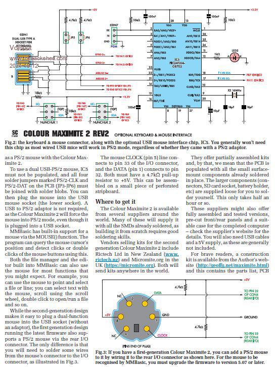

Howdy.
I need a simple mouse testing program to confirm the mouse is working.
I have a client where the mouse won't work in the file-manager - no pointer is showing up.
He is using a MS Basic Optical mouse v2.0, model 1113, so it SHOULD be working perfectly.
This is the EXACT mouse I have here and that I use to test every unit.
He has issued OPTION MOUSE 0, and does not get any timeout error, so this is strange that a known compatible mouse is not working for him.
I pre-blobbed the four solder-blob pads here so I could test the mouse on the bench before sending the unit, but now he gets it, plugs in his identical mouse, issues the command to initialize it, and it won't work.
Mouse light is glowing underneath, so the CMM2 was able to initialize the mouse, but the pointer is not showing up in FILES as I would normally expect.
This is odd....
Can someone rustle up just a simple bit of code that will draw the mouse-pointer on the screen maybe with a button to click on etc.  The code would need to report if it can't talk to the mouse for some reason.  I have not had time to play with the mouse feature of the CMM2G2 yet other then just testing it is working inside FILES, so it would be faster if someone who has played with the mouse can help with a simple bit of tester code.
Thanks.

I'm not familiar with the gen 2 version, but don't you blob one pair of jumpers or the other, depending on which type of mouse is being installed? I think I saw something about not blobbing all four of them.
EDIT:
Scratch that. You need to blob all four & install R80 and R81 (4k7) for a PS2 mouse. You've not to install the Hobbytronics chip if the board is set up for a PS2 mouse.
I was going to suggest not configuring the mouse, but setting up those GPIO inputs as ordinary DIN types then manually pulling them down to prove that the hardware was working. Unfortunately I don't know the GPIO pins for the Gen 2, only that they aren't the same as the Gen 1.

Not sure if this is of any help.
The text about mouse on the Silicon Circuits article ?
