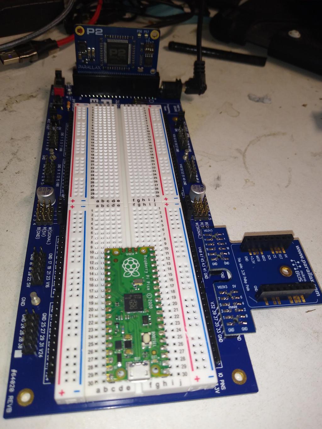

16 cogs (cores), actually; Two P2s and One Picomite
Or 17 (18?) CPUs counting the Picomite
I'm going huge overkill because I'm tired of running in to performance challenges.
I want something that will out-gun the commercial high-end controllers that used to cost me thousands and that have too much of what I don't need but not enough of what I do need.
Galil Motion Control boast that their flagship's onboard BASIC-like (but crude) interpreter executes at 25,000 lines/sec. Picomite, without over clocking is 4 X this.
Every P2 pin is a "smartpin" that can handle DIO/DAC/ADC/counting/quadrature-decode etc., etc.
Furthermore I am able to tackle anything without leaving my BASIC comfort zone and even with a lot of fast real-time stuff happening, I won't need a single interrupt (although they are supported).
P2s BASIC is modelled on FreeBASIC
The Pico will be ubiquitous and Parallax simply don't have an EOL (end of life).

  Quote  16 cogs (cores), actually; Two P2s and One Picomite
What would be the role of the Picomite be in this configuration? Can't its job be absorbed by one (or a few) of the cogs? Part of the huge overkill plan?
I guess a decent analogy would be a conventional CNC controller that is commanded by interpreted G-code.
The master controller is the interpreter and the P2s will contain the compiled "black-box" functions that drive the actual machine.
It's a real time saver to be able to edit machine sequences directly on the machine without having to compile, etc.
The Mites also have lots of other neat capabilities such as file handling, watchdog, etc. The dedicated STM watchdog that I was looking at, cost more than the Pico (IIRC).
A bonus is the multiple program slots; I might have stable code running but then I might issue an update. I could have the update in a separate slot so that if the user comes across a bug after extensive testing, they can switch back to the stable version.
I don't do conventional CNC machines, I am in a niche industry where pretty much every project has its own specific requirements involving multi-axis coordination, master/slaving of axes, etc. Always a lot of code development and I need to keep it as simple as possible in order to not lose my posterior.
