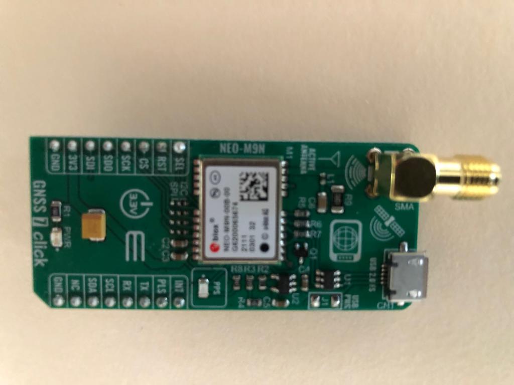

I'm trying to use the GNSS 7 Click board with the Picomite. The GNSS 7 is one of the more advanced NEO-M9N ublox modules and includes Tx and Rx pins and an I2C interface.
I have used it successfully with an Arduino and the I2C interface. However I cannot get it to work with the Picomite via the TX/RX connection using the default 9600 baud. I would appreciate any suggestions about how to make this work.

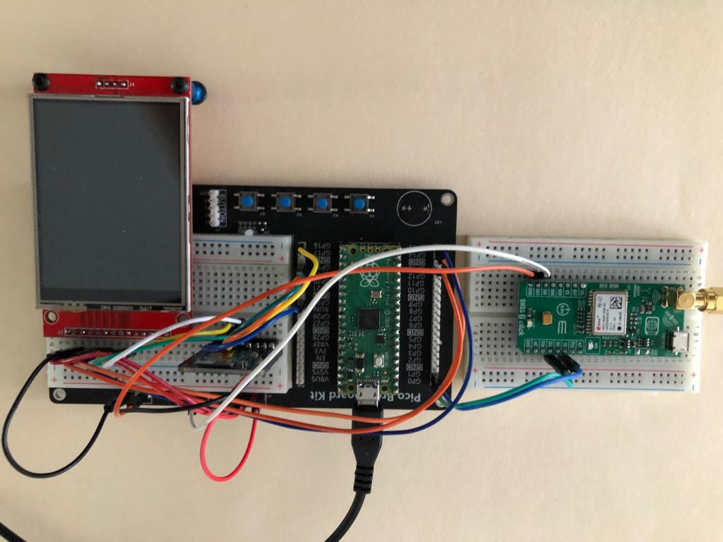

Here is a picture of the Picomite/GNSS 7 setup.
The following is a listing of the main MMBASIC code (without subroutines) including Peter's suggestion.

When the code runs and I monitor via Teraterm, lots of strange characters appear on the screen.

Some idea's:
1/ For the UART to work, you need to pull the D_SEL pin high (the pin is called "AN" in the microbus module silkscreen)
2/ The baudrate can be anything between 4800 and 900kbaud. Maybe it is set default to 4800baud.
Edited 2021-10-15 19:58 by Volhout

  Quote  When the code runs and I monitor via Teraterm, lots of strange characters appear on the screen.
Sounds like the PicoMite UART input may be inverted. Try a npn in the TX line from the GPS

When nothing's being sent you could look at the volts on Tx/Rx to see pretty surely whether their signals are inverted.
