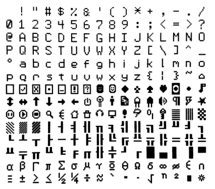

Hi folks,
This might be a RTFM question, but maybe someone will indulge me as I'm being lazy and don't have a Pico at hand at the moment.
1. Does the PicoMite (via an external display) support the same special characters (ASCII 128+) as the CMM2 - presumably only fonts #1 and #4 if it does ?
2. Is one of those characters particularly intended for a low battery warning, I can't see an obvious battery symbol:
Posts: 11865
Posted: 12:17pm 29 Oct 2021
  Quote  1. Does the PicoMite (via an external display) support the same special characters (ASCII 128+) as the CMM2 - presumably only fonts #1 and #4 if it does ?
Yes, No
Workround: Use Jim's font editor to create a font with just one character
Posts: 4398
Posted: 01:27pm 29 Oct 2021
Thanks Peter, there's a actually a lightning bolt that will do for the moment if it is rendered in red and flashing.

If it was me
I would use these characters I have in Red to show from
Full to lower to low to Out !
&H80 and &H81 (empty box and box with check mark)
&H84 and &H85 (box with lower line and box with ! )
And yes, font 1 & 4 have those characters on the Picomite
tested with an N5110 display
Rob
