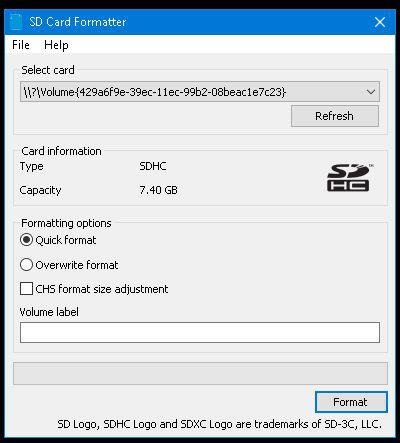

Hi all.
I'm not sure if this is related to a recent MS update, but I wouldn't put it past the bastards.
Intel NUC machine running my last copy of Windoze, which is Ten Pro x64.
I use the SD card slot reader on the side of the NUC all the time, but for the last few days, Windoze flatly refuses to talk to ANY SD card I put in there.
Interestingly, SD CARD FORMATTER does see the card, but with an extremely weird path:
WTF?
Out of interest, and to make sure it was not a case of a worn-out SD slot, cos as I mentioned, I use it heaps, I booted a copy of Linux Mint from USB, and it detects and talks to the card just fine, so it IS a Windoze problem, not a hardware issue.
Anyone else see this?
I guess I could TRY reinstalling the driver for this, but Device Manager says the device is working correctly, when it clearly isn't....
I'm just about at the stage of turning this last W10 machine into a Linux Mint machine, and run a very minimal XP as a VM just to allow me to run the CAD software I need, cos I am getting so sick of these kinds of Windoze issue that do not seem to crop up in Mint .  Sigh.

UPDATE: Have fixed this.  For reasons still unknown to me, Windoze had stopped assigning a drive-letter to the SD card - I still can't work out WHY that would be.
Open Device Manager, the card shows up there, less a drive-letter.
Right-click the SD card, assign a drive letter, and let Windoze choose a drive letter - F: in this case.
So, all working again, but this is weird.  I wonder why Windoze would just seemingly forget how it goes about assigning a drive letter to an SD card, and I have to assign it manually?
I have safely-removed the SD card and put it back in, and Windoze picks it up - now.
Strangeness.....

This is just a guess.
Perhaps Windows Update replaced the driver and lost the old configuration settings (or they were not compatible with the new driver). Assigning a drive letter has forced it to make a new config. so now all is well.
