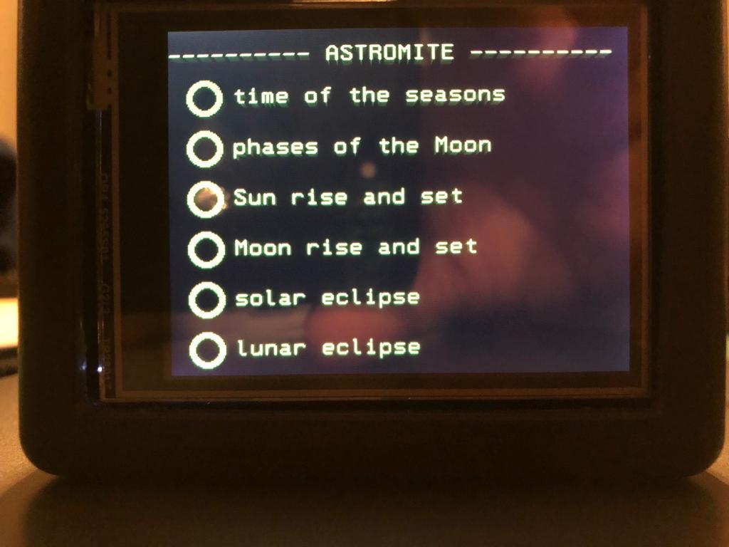

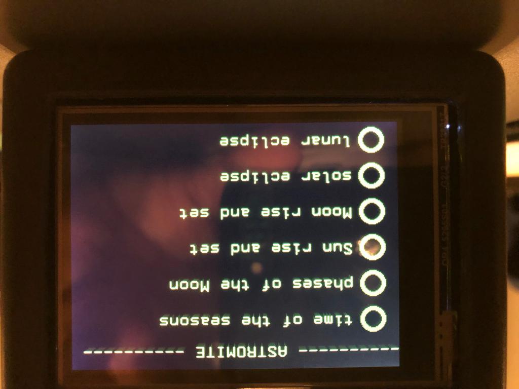

This post describes a portable interactive astronomy calculator using MMBASIC and the Pico Waveshare 2.8 inch display/SD module.
Here's a picture of the ASTROMITE main menu.

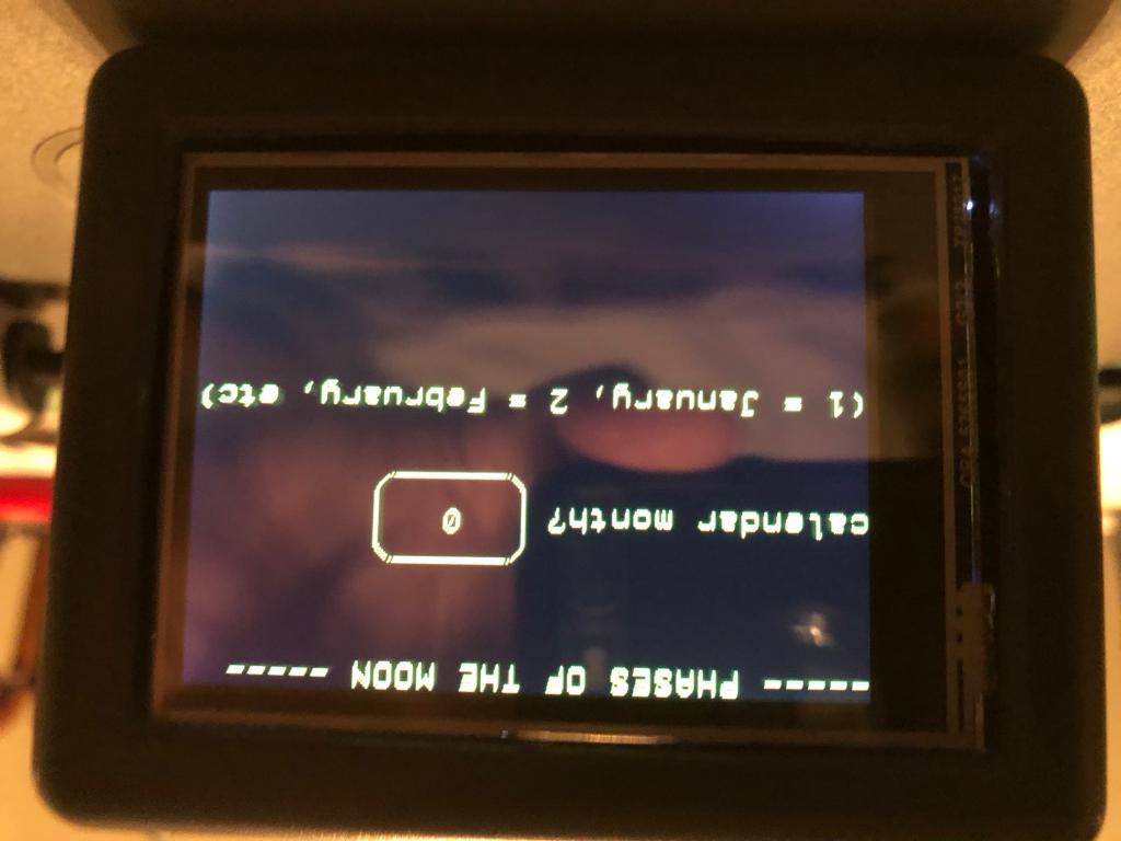

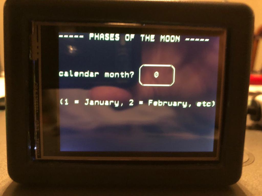

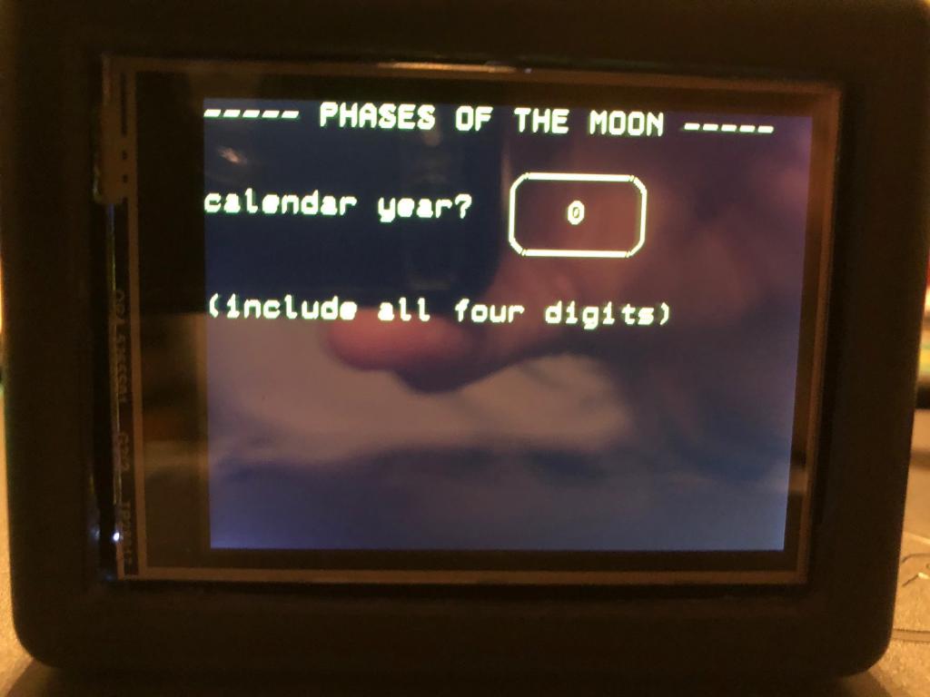

Here are two pictures of typical ASTROMITE input screens.

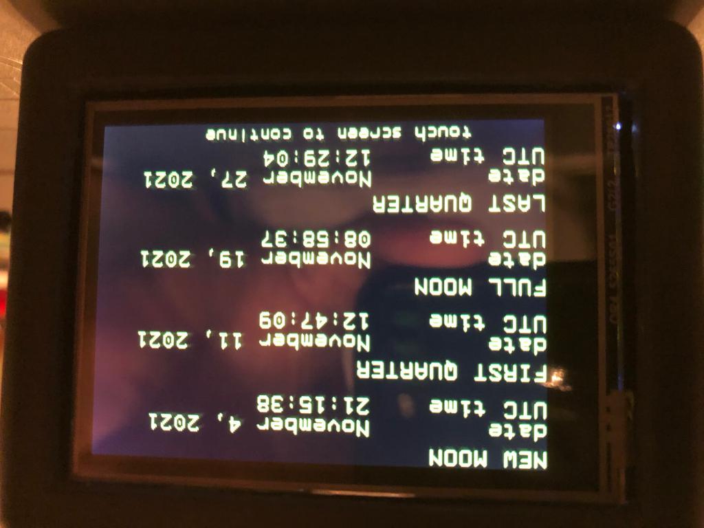

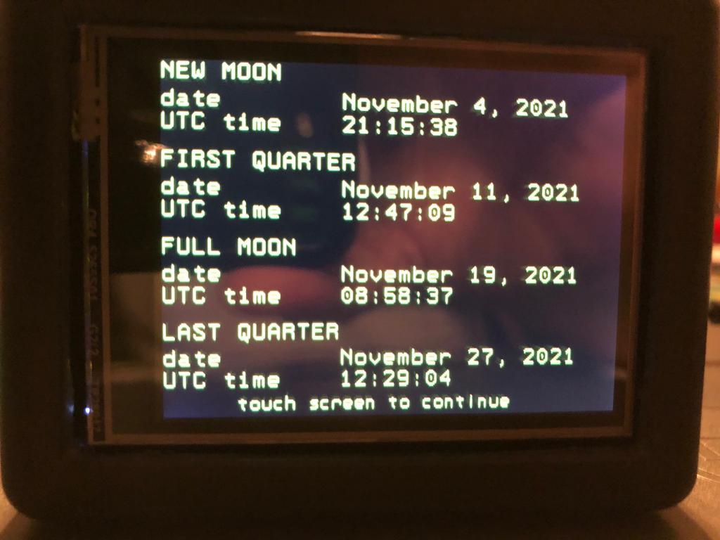

Here is a picture of a typical ASTROMITE output screen.
The main menu resides in flash slot 1. Each application resides in its own individual flash slot. The MMBASIC software for each application has been posted here previously. The input and output of each program was modified for a touch screen.
After an application completes its calculations it returns control to the main menu.
An observer's coordinates are stored in a simply ASCII file called observer.dat on the companion SD card. Here's an example for Cape Canaveral, Florida USA.

Here's the MMBASIC source code that opens and reads the observer data file.

(I did not flip my monitor up-side-down :)

Very easy to read, I just stand on my head.

Don't you just love the part of the JPG standard, specifying how the image rotation bits are used, that is so freely ignored by phone manufacturers?

@cdeagle: ...is this really the full code?
Frank
cdeagle
Joined: 22/06/2014
Posts: 269
Posted: 08:50am 05 Nov 2021
Anyone know how to import photos without standing on your head? They look fine on my computer.
@Frank ... no, just the code that reads the observer coordinates. Each application is many lines of MMBASIC code.

Posts: 8981
Posted: 10:02am 05 Nov 2021
@cdeagle
You may have to load them into a photo editor and re-save them. In theory the editor will overwrite the rotation bits to the current rotation as it saves. Don't worry too much - this is a really common problem (although, admittedly, I've not seen it on this particular forum before).
My favourite free photo editor is PhotoFiltre 7. It's really good! And IrfanView to view pictures. Deceptively powerful. :)
cdeagle
Joined: 22/06/2014
Posts: 269
Posted: 12:30pm 05 Nov 2021
Thanks Mick. I'll check them out. I'm currently using Microsoft Photos which could explain the problem.
cdeagle
Joined: 22/06/2014
Posts: 269
Posted: 04:06pm 05 Nov 2021
Attached are photos that don't require standing on your head or turning your monitor 180 degrees. Re-saving with PhotoFiltre 7 did the trick.
