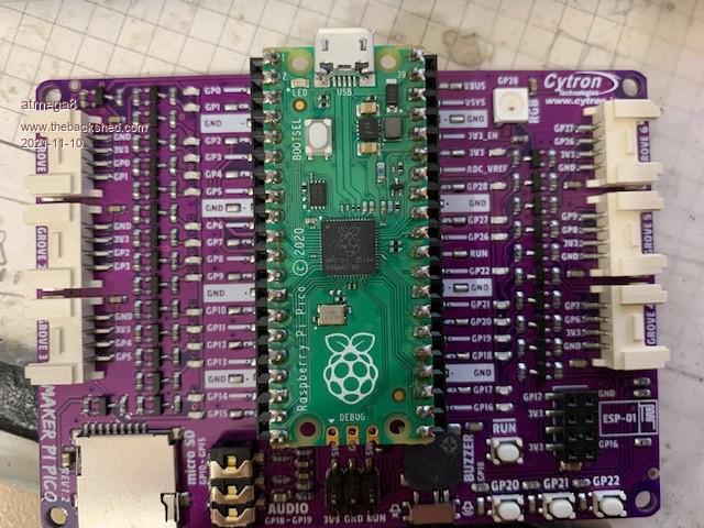

Hallo,
is there anybody out there, who can tell me how to asign the correct pins with
OPTION SYSTEM SPI.........

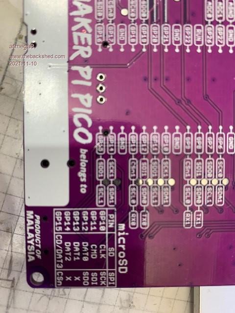

Posted: 05:01pm 09 Nov 2021
Hallo Zweifinger,
but with this Board the pins are routed to fix Port, see Picture above.
So it is not compatible ?!

Posts: 11864
Posted: 05:17pm 09 Nov 2021
Just type
option system spi GP10,GP11,GP12
option sdcard GP15
The labelling on the card is from the SDcards perspective hence SDI connects to MOSI
This is the card I developed the Picomite on. I do know what I'm talking about
Edited 2021-11-10 03:18 by matherp

atmega8
Joined: 19/11/2013
Posts: 738
Posted: 05:24pm 09 Nov 2021
  matherp said  Just type
option sdcard GP15
Hello Peter,
typed it again bot without spaces.
Now initialization works like a charme.
THX
