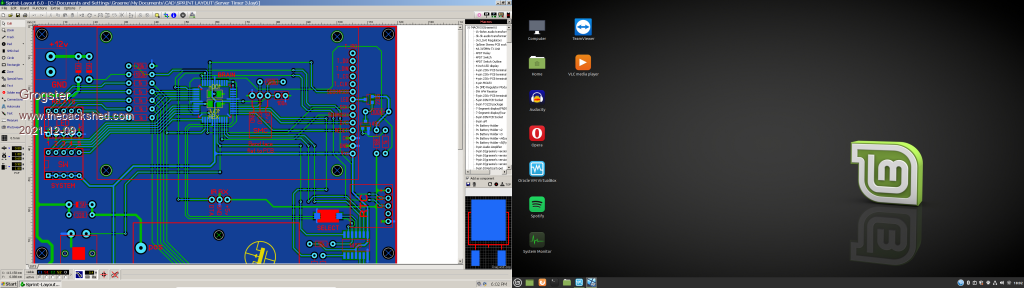

Tonight, I put the latest Mint setup online, complete with dual-screens with one screen being used for an XP VM for my CAD software, with the other screen for everything else in Mint.
Bye, bye, Windoze....
Well, in as much as I can.
XP VM on the left, Mint on the right, with Mint in total control of everything.
I have ten tabs open in Opera browser, along with the XP VM, and the RAM use is only 3.2GB out of 8GB.  Under Windoze 10, the RAM was pretty much maxed out with that setup.  I don't know why.
The XP VM runs very zippily and there is no lag there at all, and everything is stable.  I have the USB flash-drives working, and also the local USB printer too, so I can print drafts from the CAD software.  That was a big thing that I was not able to do before when I played with VM, so I feel I have learnt something else new.
I have a whole heap of apps and documents to copy over etc, so the saga continues.
My business invoicing software won't run in Linux, so I plan to just run it inside the XP VM now that I have printer support working, so that's another one fixed.

First of all, congratulations you got it working. I think you will get the hang of it more and more, and will not look back.
However...
That is not entirely true. In fact you are only running Windooze now.
It would have been different if you used Wine/PlayonLinux. But running Windooze in a VM is still running Windooze.

@ JohnS: Thanks!  Printer - I downloaded the WINDOZE drivers for it, and copied the ZIP install file to the VM.  Expanded the ZIP inside the VM to a folder.  When I then selected the printer via the VM: DEVICES/USB/{the printer} and rebooted the VM, XP detected a new printer and wanted the drivers.  I pointed the VM XP to the location of the drivers, and it was standard from that point on.
@ Volhort: "That is not entirely true. In fact you are only running Windooze now.
It would have been different if you used Wine/PlayonLinux. But running Windooze in a VM is still running Windooze."
"In fact you are only running Windooze now." - Huh?
I am NOT only running Windoze now, I am running MINT with a VM Windoze that I HAVE to have, to support the CAD software.
Also, just a wee quote of my own post if I may: "Bye, bye, Windoze....  Well, in as much as I can."
...I note you neglected to mention that last bit when you quoted me...
EDIT:
"It would have been different if you used Wine/PlayonLinux."....
But that is simply NOT POSSIBLE.
I tried.
But Wine/PlayonLinux is UNSTABLE running these CAD softwares.
The only way I can run them - STABLY - is inside a VM.
So, that makes my attempt to move to Linux invalid to you, cos I am still running a VM Windoze system......because I have to.  Bah.
