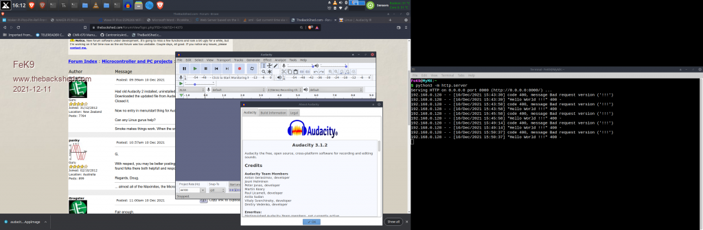

Had old Audacity 2 installed, uninstalled it.
Downloaded the updated file from Audacity, installed it, it ran fine. (v3.1)
Closed it.
Now no entry in menu/start thing for Audacity anymore, and I can't find the program to run it or add it to the menu/desktop.
Can any Linux gurus help?

If you can look in the downloaded file you should hope to see some file names you could search on or try (in a terminal) such as
find / -iname '*audacity*'
It may print a lot of paths LOL but hopefully including what you want.
(I think your experience is due to DIY install.)

Usually the menu entries are stored in .desktop files on .local/share/applications in your home folder or at /usr/share/applications
You also can click with the right button on the app menu button and edit the menu. From there you can access the menu editor and create menu entries using a graphic interface.

I found that I can make version 3.1 run, if I REINSTALL the older 2.4 via the Software Manager, and then copy the Audacity Appimage to the desktop and run that.
Perhaps not ideal, but it works.  I would love to know how to change the ICON from the cog to(ideally) the Audacity one.  I know you can use emblems, but they are not icons, so a change icon method would be handy to know at this point.

If you want to do this manually, the way to replace the cog with a nice icon is as follows:
First of all, locate the icon you want to use. Note it's location and name (or place it in a location where you can find it (i.e. ~/graeme/icons)
Open a terminal screen
Become root (sudo su)
Change to /usr/share/applications
Check this folder for a file called "audacity.desktop" (or "Audacity.desktop).
Edit this file (note, you have to be root to do this). i.e. nano audacity.desktop
There is a line in this file that starts with "Icon....."
In this line type (or copy) the exact location of your new icon. This desktop file originated from 2.4, and may have a link in this location to the old icon. And that may have been removed when you copied 3.1 over it.
Save the .desktop file
Close the terminal
If you go to the menu, you will see that audacity has used the new icon. If you also have a icon at the desktop itself, you may have to remove that one and make a new copy from the menu (or reboot the system).
