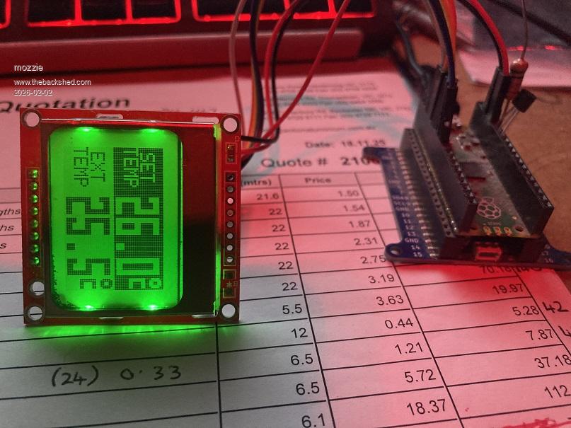

mozzie
Joined: 15/06/2020
Posts: 470
Posted: 02:15pm 01 Feb 2026
G'day WJSMarine,
These displays are great for low power and daylight readable applications.
I use the following connections and settings:
SCLK=GP2, DIN(MOSI)=GP3, D/C=GP5, RES=GP6, SCE=GP7
OPTION SYSTEM SPI GP2,GP3,GP4
OPTION LCDPANEL N5110,L,GP5,GP6,GP7
And this to test the display with the temp from a TMP36 sensor on GP28
' Program to display temps on N5110 Display

And it looks like this when you change the backlight LEDS to green:
This font is designed to be easy for a blind old fart like me to read
Lyle.
