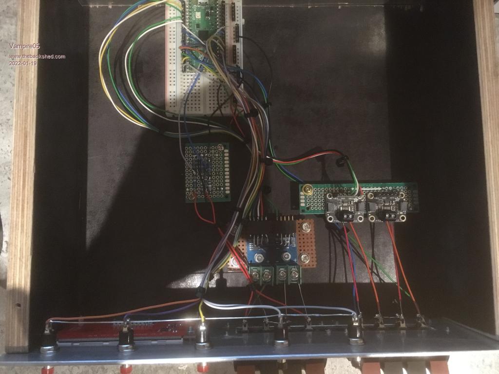

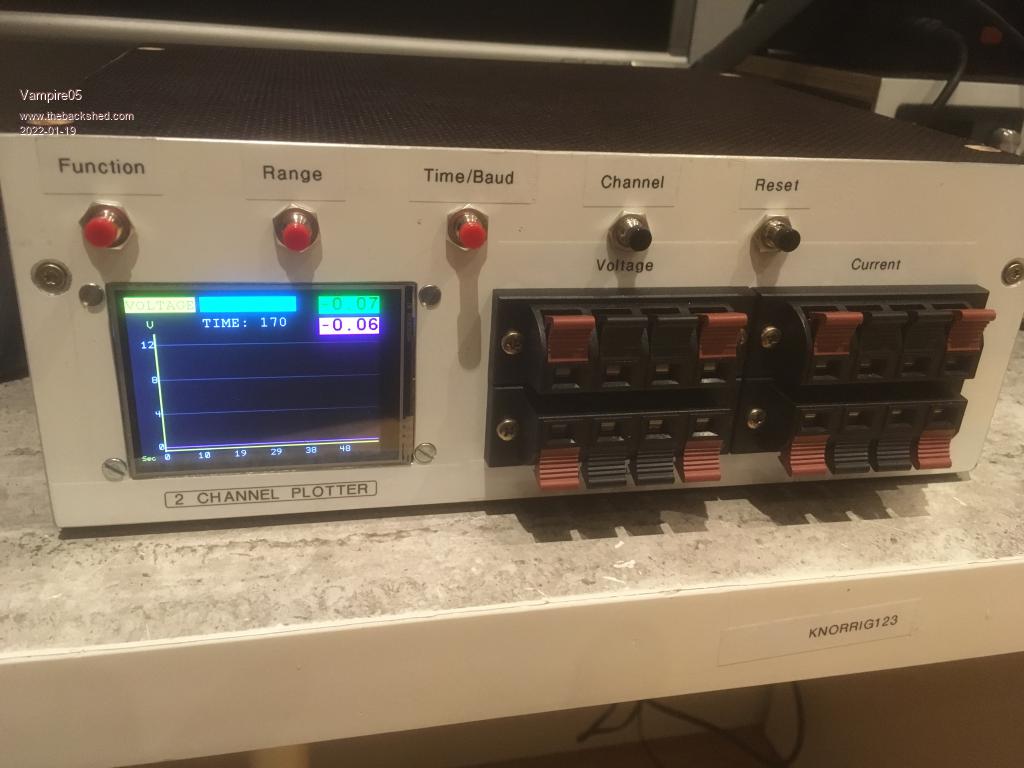

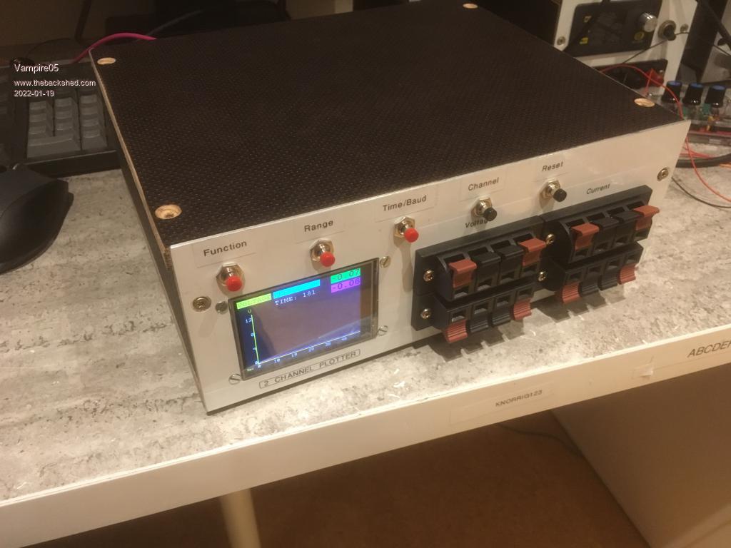

Hi Guys,
here is my actual Project: An LCD Plotter with 2 Channels and 4 different Signal Inputs:
- Voltage (0-12V, 0-6V, 0-3V, 0-0.9V) -> Raspberry Pico ADC with Voltage Devider
- Current (0-3A, 0-900mA, 0-90mA, 0-9mA) -> INA219 Board
- Temperature (0-600DEG, 0-300DEG, 0-90DEG, 0-60DEG) -> MAX6675 Board
- UART with different Baud Rates (not implemented)
- Simple DSO Function:
Here are some Videos:
Part 1:
https://youtu.be/ItWgfYGwKK0
Part 2:
https://youtu.be/hKAYqFlSEQ4
Here is the Code:
