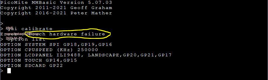

Hello,
I've tried to configure ILI9488 display with my previous ILI9341 setup ( ILI9341 works great), but after GUI CALIBRATE, I touched first two targets with no problem and suddenly calibrate procedure stop with a message "Touch hardware failure".
Any solution for this problem?
GUI TEST LCDPANEL works.
Thank you.

MMBasic can tell that the touch controller is not working when it gets identical values from two different touch points.  That is why you get the error on the second calibration point.
Have you disconnected the MISO pin on the ILI9488?  To quote from the manual "For this display to work the MISO pin must not be connected."
If you don't do this the ILI9488 will interfere with communications to the touch controller and the SD card.

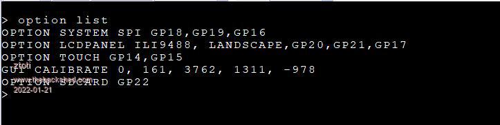

Posted: 02:53am 20 Jan 2022
Lizby,
It works with 680ohm resistor, thank you.
Also I tried without the resistor, with your calibration values - doesn't work.
Thank you again.

Glad it works, and yay for the 680R resistor. What GUI CALIBRATE values did you get (shown with OPTION LIST)?
ztoti
Joined: 27/10/2011
Posts: 65
Posted: 02:31pm 20 Jan 2022
Here is:
