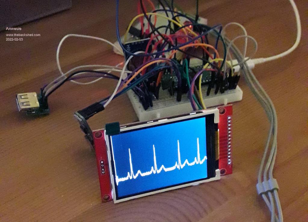

...well kind of! Short story: After building the Colour Maximite 2, the PicoMite has waaay more potenital in my opinion, because you can source all the parts for cheap in every country.
I often felt my heart does some extra beats (premature ventricular contractions)I thought I can visualize those and build an ECG. I did this in the past with an Arduino, but now is the time to put the picoMite to the test! It is really amazing how simple
you can get a primitive ECG programmed in BASIC.
No extra beats on this image :) And ignore the messy work, I already designed a PCB which is on its way from JLC.

What have you done for sensors - I guess that they are the grey cables bottom right of the picture?

Yes, it is the well known AD8232 sensor for just 3 euro in Germany, which really works great. I am sure it is possible to build a lot of features in this BASIC program. At first I will concentrate on filtering noise, but this should be no problem since there is enough cpu power, it even works on an arduino I just have to port it from C to BASIC language. I am a little bit new to this, so it will be fun as well :)
Also planned is SD card output and audio warnings, glad that Peter fixed the wav audio skipping bug in the firmware.

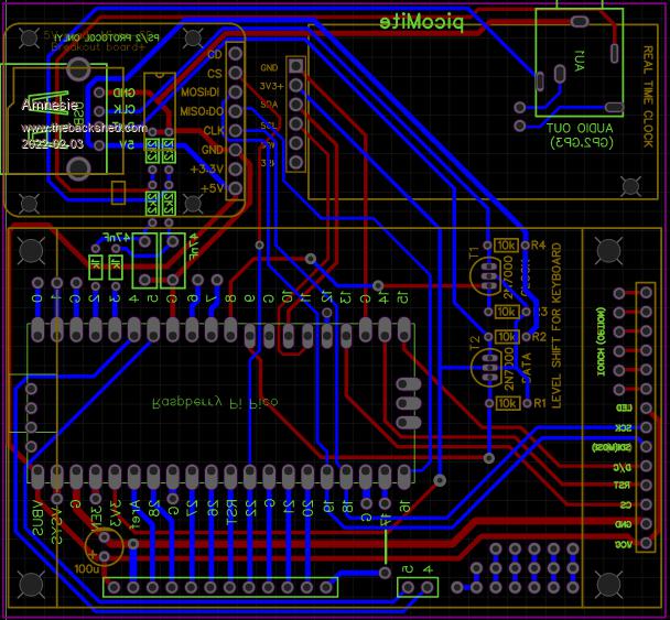

This is my designed PCB for general purpose projects for the picoMite.. if everythings works I can upload the gerbers if there is interest.
Some features like RTC, KEYBOARD, LCD, SDCARD etc.. are on board. I am not using the onboard SD socket of the display because it is bad quality... The Adafruit breakouts are way better.

I would be interested in something like this since I suffer from AFib myself.  Spent a week in the hospital and had a defibrillator used on me a couple times. Now days I have extra beats and missing beats so it all averages out.   Anyway,  it would be nice to be able a watch what is happening beyond the visit to the Doctors office every six months.

I have AF too, it gave me a stroke. Luckily a minor one and I quickly made a full recovery. So make sure you do see a doctor.
I may have to build one myself.
  Quote  notch filter to get rid of movements and 50hz noise
In that post Peter mentions synchronising the sample time with the mains to avoid hum. An active notch filter may be a simpler method.
Bill
Edit: A save screen would be handy if you see an episode that you want to keep to show your doctor.

Neat indeed. Please do post the gerbers (or wait if you think you have further refinements). And please post a link to your sensors. Which PCB design software did you use?
Maybe run MISO with an inline 680R resistor so that a larger SPI 480x320 ILI9488 may be used (although it could be used with MISO not connected as long as BLIT READ or similar isn't wanted--or, perhaps more importantly for this application, SAVE IMAGE).

Thank you lizby for your advice! I am using easyEDA as "software".
