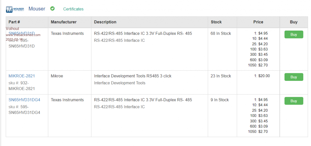

Can't get the actual SN65HVD31DR device until 2023.
Seems that Digikey will have the Click module in March though.

The SN65HVD31 has independent transmitter and receiver WITHOUT enables.
This means that they are targeted for point-point connections (not a bus like RS485 where transmitters must be disabled when not transmitting).
The one knivd proposes does not work in this application, unless you use 1 prewired for transmit, and prewire a second one for receive. In essence this method can be used for most RS485 drivers. Use 2.
The chips bigmik propose are not in a single 8 pin package, but will do the job, if the bandwidth is not required (the chip tinine needs is 2Mbps).

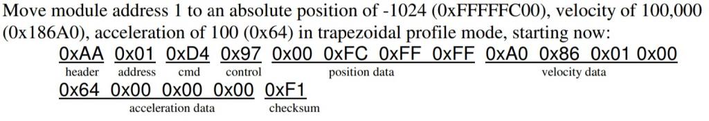

I have a bit of an unusual thing going on in that; I use 4-wire multi-drop full duplex but it is strictly command/response.
The master has the TX permanently enabled and the RX is a slave-shared response line. So there never really is any FD actually happening.

@Volhout...Good call
I was certain that I checked Mouser
Craig

@Volhout
Hey buddy
I use a binary protocol with a simple checksum. I adopted it from "NMC" (network motion control). Never experienced a checksum error and if I did, that would indicate an electrical failure and the machine would simply shut down. Here is an example:
That is an example of a command to move a motor. The motor could be a CNC axis or a robot, etc.
So here is my rhetorical question regarding noise and error checking: What about the zillions of CNC machines and robots out there? The controller receives nothing but differential 5v pulses from each encoder. There is no error checking protocol and if a few pulses go missing, the axis is either out of position or has smashed into something.
Furthermore, there is absolutely no way to keep these signals away from noise because the motors and drive-amplifiers (servo controllers) are reliant on high frequency PWM (many of mine are 100HP).
In the days prior to differential transceivers, we had to be very careful but today it's a non-issue.
So I personally wouldn't have a problem with ASCII transmissions without error checking/correcting BUT only in a case where there is no possibility of buss contention. ACK/NACK is a good idea, though. One big-name product that I have been using since the mid 80's is pure ASCII and returns ":" for ACK and "?" for NACK.
Craig

The checksum is across all except the header I found out. That makes sense. The header is to wake devices, and prepare to read the address, and act on it.
Tinine
Joined: 30/03/2016
Posts: 1646
Posted: 03:25am 17 Feb 2022
Yeah AA = 10101010
Also the "D" (decimal 13) in the "D4" CMD byte indicates that 13 data bytes are to follow, prior to the checksum.
