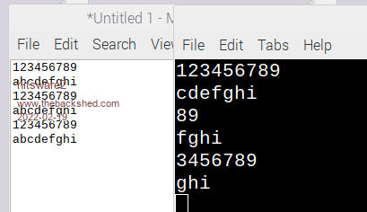

I can copy a session of MMBasic/minicom and then paste to MousePad
Works fine ....
BUT ....
If I copy from MousePad and then try to paste to MMBasic/minicom
I loose and confuse the left side ( see pic ):

  hitsware2 said  [...]I copy from MousePad and then try to paste to MMBasic/minicom
I loose and confuse the left side [...]
you are trying to paste into MMbasic's onboard editor, yes? to do this successfully you need to be using a terminal emulator that is 'MMbasic aware'. minicom is not such a terminal emulator.

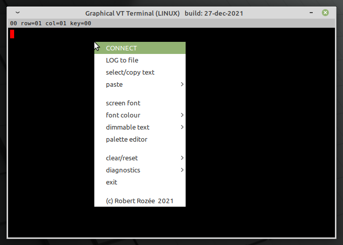

yes, GFXterm:
http://www.thebackshed.com/docregister/ViewDoc.asp?DocID=22
for the RPi, you'll need to download the source, install Lazarus 2.0.12 (not tried with 2.2.0 yet), then compile it. others have done this successfully with earlier releases of GFXterm. if you post the compiled version here, i'll add it to the doc register.
rob   :-)

hmmm, i do need to have it display some something more intuitive, like instructions, on startup!
right-click within the terminal window to bring up the menu. this is the main command interface. select 'CONNECT' from the menu, and go from there.
you can, alternatively, press ctrl-space to resume the last successful connection.
rob   :-)

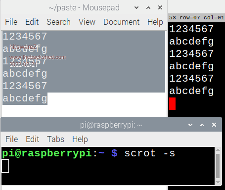

Posted: 06:02pm 20 Feb 2022
I don't know how I missed that .....
NICE
 ... When I paste, it appears slow ...
Same effect as character delay to 5 mS ..
as it should be     the speed is adjusted interactively to match the rate at which MMbasic accepts and processed the input.
if you type AUTOSAVE at the command prompt and then paste in a long file, you'll see that after half a second the rate increases considerably. if you paste the same file into the editor, the rate will remain slow as the editor can only accept input at that slow rate.
btw: when pasting into the editor, keep a space character to the right of the cursor location to disable auto-indenting. ie, press space, then left arrow before beginning the paste.

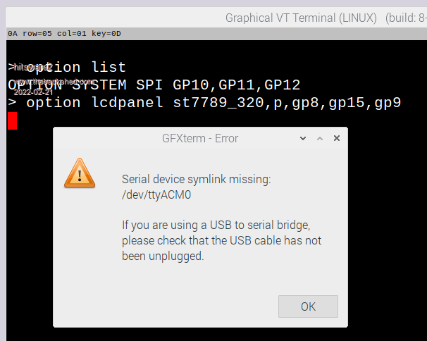

When I load options it drops the connection....???
MiniCom gives a short message, but then reconnects ....

  hitsware2 said  BUT
that is because the pico drops the USB connection when certain option settings are changed. MMbasic on the pico then restarts itself from scratch and establishes a new USB link, often (but not always) under the same /dev/tty name as previously.
you can try reconnecting (using the same /dev/tty name) by (1) hitting ENTER to close the error window and then (2) pressing ctrl-space. this may well work provided it was a 'clean' USB unplug event. on some systems the pico does not cleanly drop the USB connection, which results in either a new /dev/tty/ name being assigned, or linux's USB subsystem crashing.
if the usb subsystem crashes, the attached shell script should fix it:
fixUSB.zip
rob   :-)
