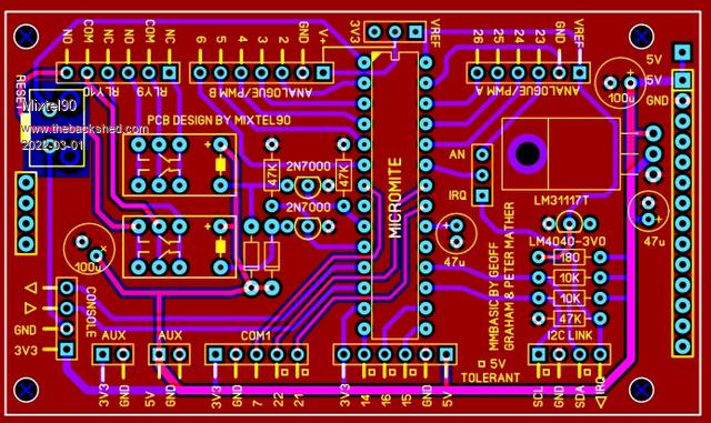

I wish the online preview on Silicon Chip would show a bit more. :( We don't get it here. I'm interested because I designed a backpack for the PicoMite some time ago. At the moment it thinks it's a power supply control front-end, so yes, they can be useful. :)

Doug, I like your design and would use it quite happily with a big display. I am also very envious of your workbench and at how astoundingly clear it is.  :)
My backpack was designed to fit into a specific box, hence the restricted size. I also experimented with the design of an intermediate PCB to sandwich between the display and the backpack. It picks up on the I2C pins that are used for the RTC and feeds them to a Micromite to add a whole new set of I/O. This was before I discovered Geoff's code to handle it, so I didn't take the design any further as I expected to have to figure out the software too. lol I might be tempted to work on it again now.

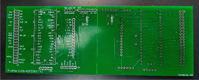

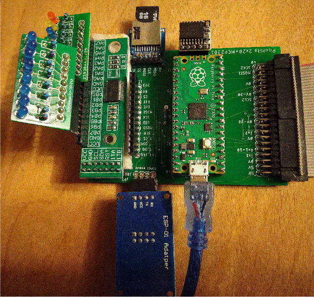

Posts: 3833
Posted: 01:06pm 28 Feb 2022
  matherp said  I'm sure someone on TBS could design one open-source.
In addition to Mick's and Doug's, there are these Picomite Backpack plus 2x20 breakout PCBs
Gerbers and Eaglecad files linked to. At last check, 5 PCBs from JLCPCB cost under $6US with slow boat shipping.
Edited 2022-02-28 23:07 by lizby

Posts: 8981
Posted: 08:05pm 28 Feb 2022
If you have any backpack that fits the ILI9341 and you are running out of I/O then this may help. It connects to your main device over I2C and gets its power from the 5V pin of the display. It can also be used as a stand-alone Micromite board by fitting a terminal block with pins on 5.08mm centres instead of the display connectors. The display connectors are the long pin type, fitted from the rear of the pcb. The backpack fits onto the front and the completed assembly fits onto the rear of the display.
This is completely untested other than using the "Test" tool in Sprint Layout.
Comments welcome as usual. No, I'm not going to include wireless connectivity or get rid of the clicky relays. :)
