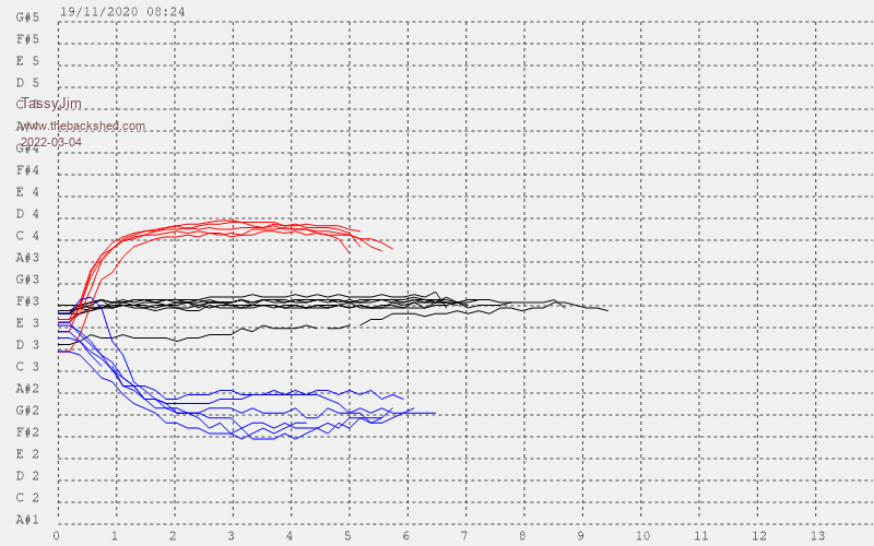

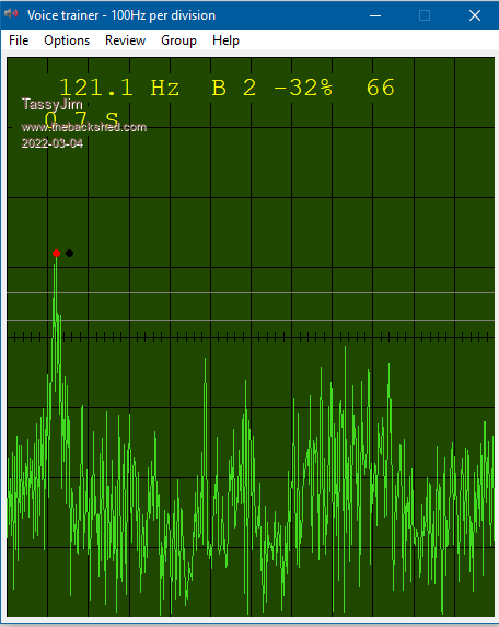

A few years ago I had need for a tool to help with voice exercises.
I couldn't find anything that was exactly what I wanted so I programmed my own "voice Trainer"
And the output:
My speech pathologist was impressed.
I still use most days.
I haven't tried to convert it to the CMM2 and probably never will.

  TassyJim said  A few years ago I had need for a tool to help with voice exercises.
And the output:
When I was looking for inspiration I found this explanation of FFT:
http://blogs.zynaptiq.com/bernsee/dft-a-pied/
It is well worth a read.

Posts: 6604
Posted: 10:41am 04 Mar 2022
  Volhout said
Nice Jim !!! Running on a laptop ?
What Choir are you member of ?
Laptop or my main PC.
I had the choice of getting successful voice training or learning sign-language.
Fortunately, the voice training was (partially) successful.
One vocal chord still paralyzed. The other one is working partially again.
