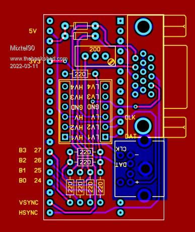

Posted: 03:22pm 10 Mar 2022
This should plug into the RH end of the backplane. It accepts a 5V PS/2 keyboard and does the necessary level shifting. Note that the sockets overhang so it has to be the end of the board. The VGA socket is the compact version, which I've not found in the UK but they are easy enough to get from Chinese suppliers.
I could just do to check it over, but I think it's ok. You can get 3 of these out of a 100x100 board if they panelize them or 4 if you cut the board yourself. This is the special offer size at JLCPCB so you get 5 boards very cheaply. For those who are comparing it with the PicoMite pin layout, this backplane mirrors the PicoMite connections so left & right are reversed.

IanT
Joined: 29/11/2016
Posts: 132
Posted: 09:33pm 10 Mar 2022
That looks really neat Mick.
I don't know if anyone else is interested in this board but I've looked at the JLCPCB site and it does seem very reasonable. So I'd be happy (assuming interest) to order some spare boards at these prices.
I'd want two, Mick of course would be welcome to some - and then I'd be very happy to supply one to anyone here who would like one (for the cost of postage). I've had great fun with my Mites and I'd be very pleased to give something back to the MMB community.

Posts: 8981
Posted: 11:20pm 10 Mar 2022
Gerbers are in my last post. :)
Ordering from JLCPCB is dead easy. Just accept all the defaults and you'll get five individual green PCBs with white screen printing. You can change the colours very easily, but it adds 2 days to your order.
I've not used their panelization system so I can't help much with that, sorry. They would probably be able to fit 3 on a single 100x100 though (there has to be a margin on two opposite sides), then you can just snap them apart. If you want them to do that it'll cost a bit extra, I think.
Incidentally, if someone wanted to play, it should, in theory, be possible to fit female headers on the back of this board and plug a PicoMite onto the back of it - but watch the pins behind the keyboard socket, they may have to be trimmed down. You'd have to power it from USB and there's no audio output or SDcard. It's probably not worth it.

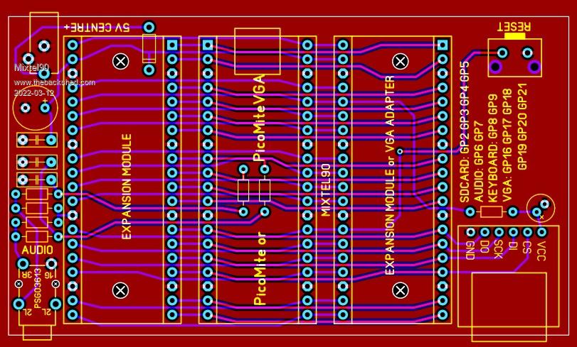

Posts: 8981
Posted: 08:10pm 11 Mar 2022
Erm... I got a bit carried away and designed a little board to take the above little board, or an ordinary PicoMite with two expansion modules. It's 100mm wide.
I really should stop getting these ideas...  :)

al18
Joined: 06/07/2019
Posts: 248
Posted: 09:46pm 11 Mar 2022
Mick,
The expansion board looks good, but seems to be missing a 3.3v LDO regulator.
Edited 2022-03-12 07:49 by al18
Posts: 8981
Posted: 10:40pm 11 Mar 2022
That's because it hasn't got one. It's using the switching reg on the PicoMite. Unless you are going to draw more than a couple of hundred mA there's no point in fitting one really - apart for wanting quiet audio, I suppose. This board is really intended to take the VGA board above and one more expansion board so it's not a lot - the VGA board draws virtually nothing.
The little barrel jack feeds up to 5V into VSYS via a diode. You could plug two AA cells in series into there. When powered from USB the diode is reverse biased so they don't get damaged. The Pico will run from them when the USB supply is removed. 3V is enough - you can drop to less than 2V on VSYS.
