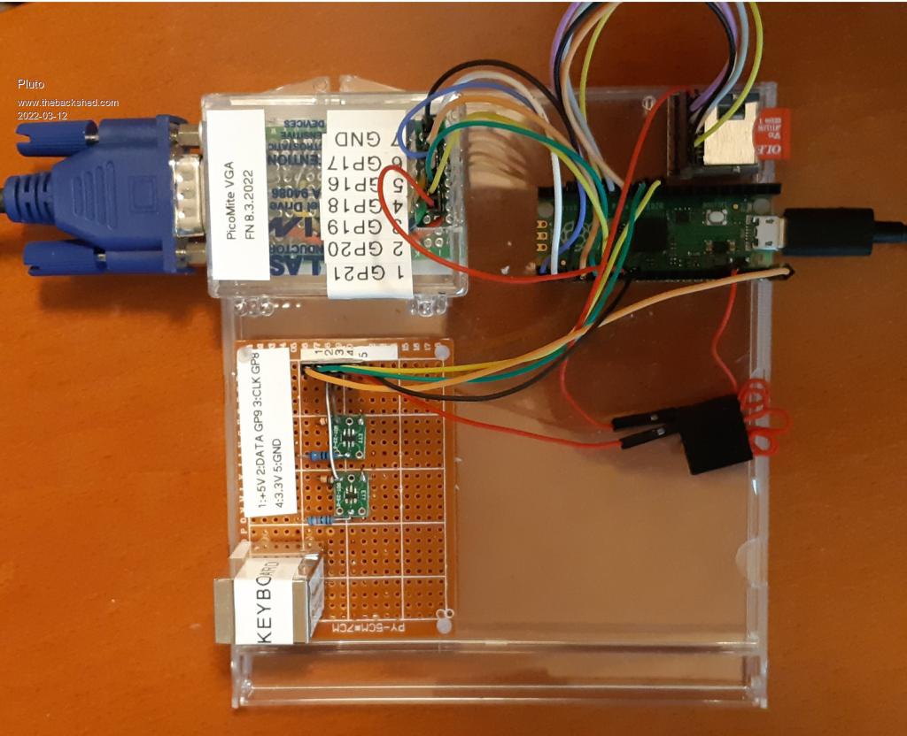

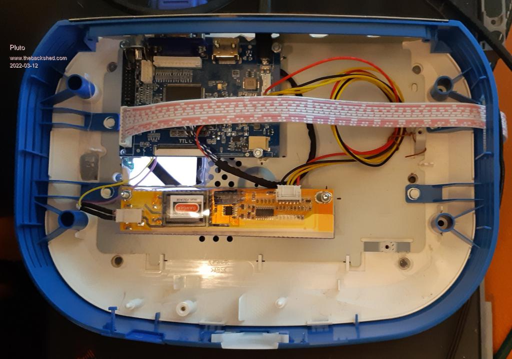

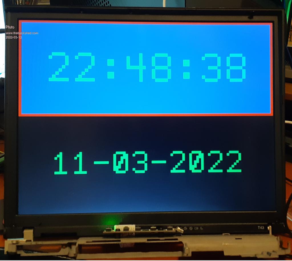

I like to recycle as much as posible. My PicomiteVGA is connected to an old LCD screen from a scrapped IBM laptop.
Inplanted on the display's backside in the enclosure of an old digibox.
The main board with PicoMite and external connection circuits are bolted to an  old DVD envelope.
NB:keyboard not yet tested.
Fully functional @total investment of less than 30USD (Picomite ca $6 + LCD driver ca $21 + SD card holder $0.60 incl freight from China).
Just now connecting to a Geiger-tube module (taken into operation after resting several years in my backshed) for monitoring eventual changes in radiation coming from south-east.  Still normal background levels on my monitor as vell as on the official measurements.

Posted: 07:31am 12 Mar 2022
I have ordered the LCD driver boards from "Yqwsyxl LCD parts Store" on Ali Express. Just send them the LCD model number and they will propose suitable driver boards for you. Fast response and fast delivery (2 weeks).
