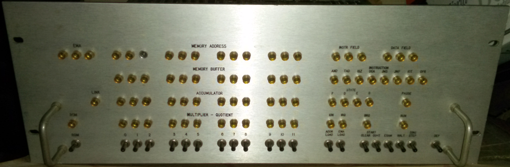

Around August 1974, Electronics Australia started a monthly series on the design and construction of a simple microcomputer called the EDUC-8. It was conceived and designed from the ground up by then then Editor, Jim Rowe.
Loosely based on the instruction set of the DEC PDP-8, it was one of the first hobby microcomputers. Built entirely from 74xx series of TTL chips, it was a fully functioning microcomputer. My brother and I built one and last I heard from him, it is still operational.
In an attempt to re-live some of those days, I have created a "glass" version of EDUC-8 - that is, a simulator written in MMB4W (it should also run on a CMM2 but untested at this time).
For anyone interested, a copy of the code is included below. It is still a work-in-progress as I have not implemented any of the IOT instructions. If anyone wants to get more deeply into the program, you will need to obtain a copy of the full manual "EDUC-8 An Educational Microcomputer" by Jamison Rowe. It may no longer be in print but I could perhaps copy parts if anyone is interested (I will try to contact Jim Rowe or EA/Silicon Chip to determine the status of the book).
