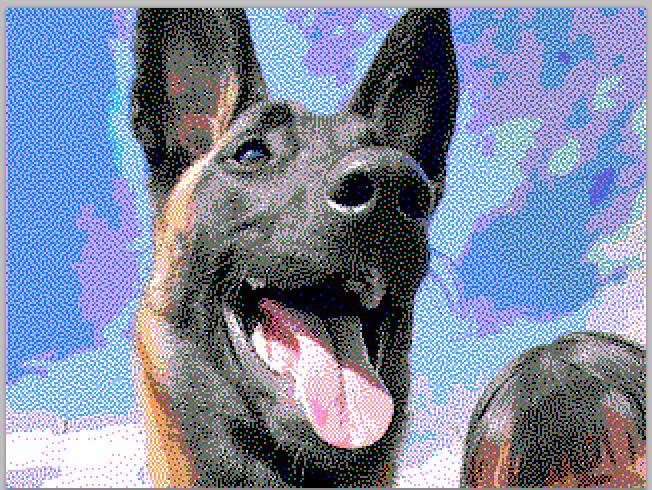

In order to at least make a meaningful contribution, I converted an image into the color palette of the picoMiteVGA with Photoshop. I'm amazed at what you can do with just 16 colors! On the monitor it looks the same :) With the saved colour palette I can now convert any image pretty quickly.
If you use Photoshop, here is the picoMiteVGA Colour Palette and you can do the same:
colourPattern.zip
Our dog Tali:
