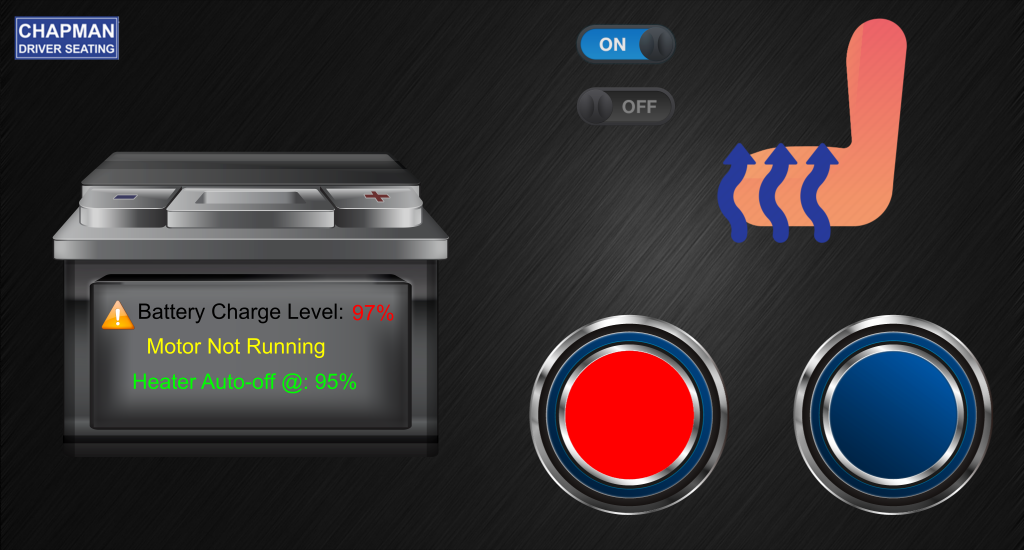

My client is a producer of coach driver-seats and he wants to incorporate heaters. They intend to fabricate a metal enclosure with a "rugged switch" and have asked me to come up with a small control unit. I don't agree with their suggestion that this should be simply ON for a factory preset time and then OFF for a preset time. My belief is that this will burn the driver's buttski. I'm thinking; one of the tiny Picos, driving several levels of PWM, maybe three levels; low/medium/high. Any opinions on this? I have received a couple of these heating elements and that is basically it, just two wires. I measure 52R element resistance. Craig |

@Volhout: Sorry, typo...that should have been 5.2 ohm They already know that if it's cost-sensitive, they're talking to the wrong guy ![]() Yeah, I brought-up the 24v question. I don't know if they bring that into the cab...waiting for clarification on that. @Cap'n: PID is what I do so no problem there @Mick: Client needs to be able to play with parameters such as PID gains and whatever timers we come up with. I was also thinking about some form of power-setting indicator. They are talking an initial order of 200 units and so I'll insist on a downpayment that would cover all components. Of course, I got carried away and proposed a mobile-device/Bluetooth controller but I think that was a bit much for them Rough idea: ![]() Craig |

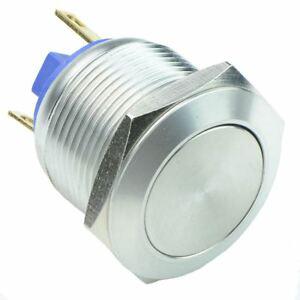

It's the old game of coming up with something that's their own brand. I mean, this will probably be a stainless-steel enclosure with laser engraving...they have all the equipment for this and any knobs or pushbuttons must be rugged: ![]() Craig |
