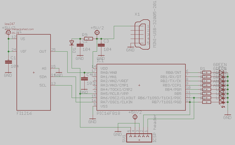

It's the code for a Tetra detector, as in the radio's used by Police, Ambulance and Fire services in Europe
The original code was written for a PIC16F818 and uses code like this which I have no clue about

The version I'm thinking of building uses an old analogue tv tuner as the bandwidth of 1 channel is 8 Mhz which is enough to monitor the whole tetra band at once looking for any signals
All the tv tuner has to do is be tuned to around 382.50Mhz which most wideband tuners could do as they covered the VHF and Cable channels as well as the UHF ones
One such tuner was the FI1216 which is tuned by it's I2c bus.Remove the TDA9800 demodulator and insert an AD8307 92 dB Logarithmic Amplifier and then send the output into a pic as the person who wrote the code did
but I reckon a Pi Pico running MMBasic would do it a lot better and easier

I am afraid no-one can. This is only part of a project.
It is a header file for a project, that defines the fuses of the particualr PIC processor (like WDT = watchdog timer ON) and a set of definitions for variables used in the C file (or assembly file, or basic file).
As Tom pointed out, the ";" is a separator used in MPASM (Microchip Assembler).
In essence: you are missing part of this project. This is only one of multiple (2 or more) files.

The datasheet for the TV tuner IC is readily available.
Pin 25 is the audio out which the PIC monitors, probably just for any activity.
Not a major programming challenge.

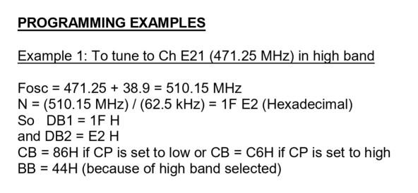

I've been trying to work out how to use the I2C bus to program the tuner to go to 382.5Mhz
I've attached the datasheet of the tuner I'm going to use which gives details of the I2C bus and how to program it but it's all gobblydygook to me
I've got as far as I need to set the Tuner to Mid Band which is
0 1 0 0 0 x x x  P0-P7
the AGC controls need to be set to either 001 high, 010 (power on mode) or 101 low
to set the frequency it "seems" to need the following
Address Byte  ADB
Divider Byte 1  DB1
Divider Byte 2  DB2
Control Byte CB
Bandswitch Byte BB
Auzilary Byte AB (AGC)
Using the example given they used
I've managed to work out that I need to set the tuner to 421.5Mhz? or do I considering I'm removing the demodulator from inside it
Using this frequency I need to set the following
421.4 MHZ
N = 1A 56
DB1 = 1A H
DB2 = 56 H
CB = ?
BB = ?
I'm conpletely stumped to be honest
If anyone gets the time or inclination to look at the datasheet could you tell me the data I need to send on the I2C bus to do the 2 following things please
Set Frequency to 382.5Mhz or very close to it
Set AGC level to 001
Set AGC level to 010
Set AGC level to 101
I can work out the rest of the program myself (I think) it's just programming the actual tuner that's my issue because my knowledge of I2c is cr@p and the ability of my brain to process and store the knowledge to understand it went when I got my memory issues
Of course I coule be completely wrong in how I've interpreted the datasheet and maybe if I am then let me know and I'll just give up on this

Hi Lew247,
Since you are in the UK you will have either a system B/G or system I tuner (not system L for France).
Meaning the tuner runs at 38.9MHz IF (intermediate frequency).
When you program the divider to &h1A56 to achieve 421.4MHz you use 16 steps per MHz in the PLL settings (62.5kHz step).
Since you want to tune to 380MHz, you are to use MID band (not high band since that starts at 442MHz up). Mid band is set with writing &bxxx00002 (or &h02) to BB.
The control byte (CB) must be programmed with &b10000110 to work with 62.5kHz steps, and use low current charge pump (slower tuning, but better matching 62.5kHz steps).
So CB must be set to &h86.
I hope this helps,

Posts: 6107
Posted: 06:05am 25 May 2022
@lew247
Depending on the connection you make to pin 6 of the tuner, the I2C address changes.
In the datasheet is the 8 bit address, but MMBasic uses 7bit addressing.
pin6=GND : I2C address = &h60
pin6=1.7V: I2C address = &h61
pin6=3.3V: I2C address = &h62
pin6=5V  : I2C address = &h63
I have not been able to find out what the register addresses are, so it may be possible that this tuner does not support individual register setting. And you must send all 6 registers always. This you should be able to derive from the PIC code.
Good luck, nice project.....

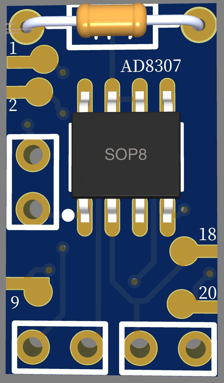

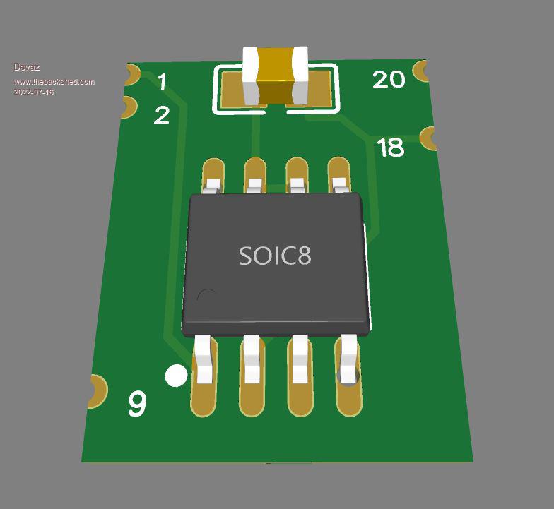

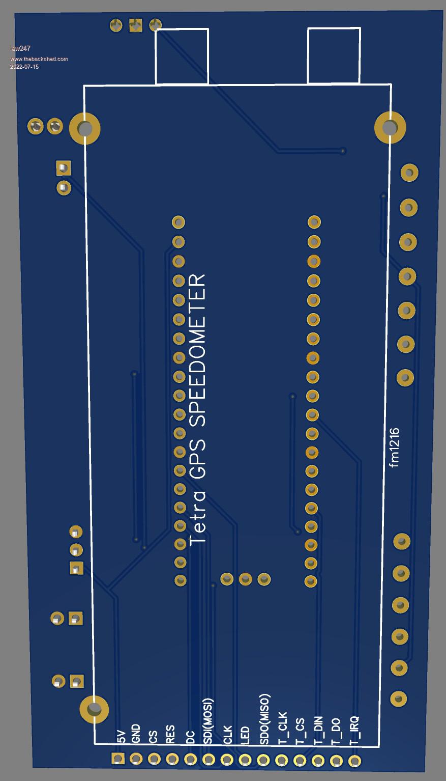

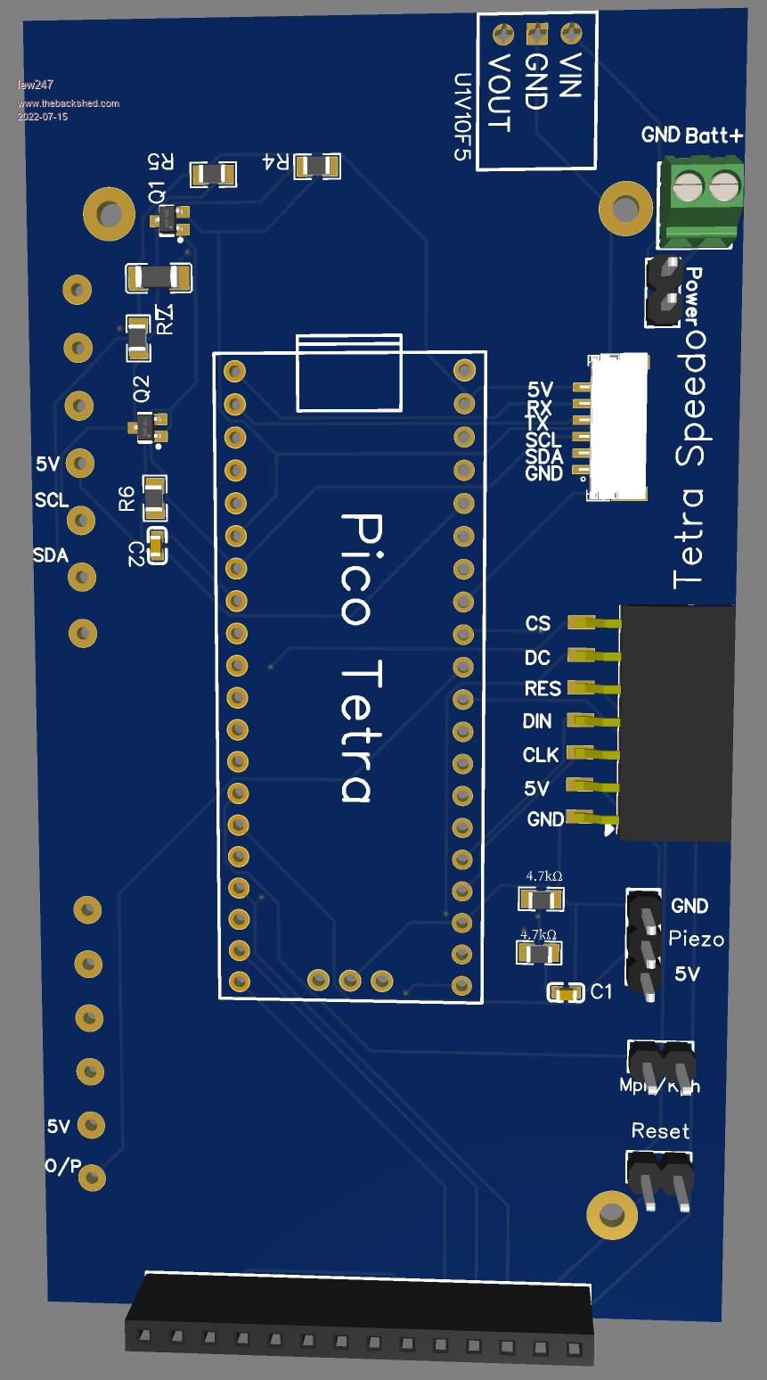

I just got the boards back from JLPCB today so once I get someone to take out the TDA9800T and solder in the board I had made, It should be relatively easy to get working
I made two boards, one for the Fi1216 that either an OLED display or one of the 2.5/3.5 displays will fit onto along with a gps/compass unit so the unit can show true speed when mounted in the car as well as tetra alerts
the 2nd board contains the replacement for the TDA9800T to convert the signal to voltage to feed to the picromite
(the board says FM1216 but should work for either)

I think BB=&h02, CB=&h86 (or &hCE ??).

@lew247
The PCB is nice but i think u need an extra amplifier for the signal.
