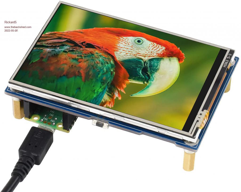

are you talking about this one with the Pico socket on the back?
OPTION LCDPANEL ILI9488W, LANDSCAPE,GP8,GP15,GP9,GP13
OPTION TOUCH GP16,GP17
This One .....

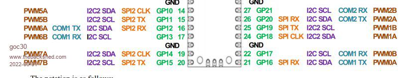

goc30
Joined: 12/04/2017
Location: France
Posts: 435
Posted: 05:25pm 28 May 2022
  matherp said  Which display? All the waveshare ones are tested and working fine
with WaveShare Pico-Eval , I have 2 problems
1 SdCard is on second SPI and LCD on first SPI. For that "option sdcard" don't work because it use "Option system SPI" with MOSI, and CLK of LCD lines
2 Buzzer use only 1 line, but "option audio" need 2 lines (left and right). It is not possible to declare only 1 line

hitsware2

  Mixtel90 said  SD cards are handled by MMBasic as bitbang devices. They don't use the on-chip SPI hardware even if they are connected to it. In fact, you can use any pins for a SD card. See the manual - there are two ways to use OPTION SDCARD, one working with OPTION SYSTEM SPI and one without using it.
in doc it said
OPTION SDCARD CSpin[,CLKpin, MOSIpin, MISOpin]
I have this
> option list
OPTION SYSTEM I2C GP6,GP7
GUI CALIBRATE 0, 3970, 219, -1285, 880
> option sdcard gp22,gp5,gp19,gp20
> files
Error : SD Card not found
my SDCARd work with cmm2.
And where Picomite use CMD line ??
In schematic, it seem that GP21 and GP22 are not use
  Mixtel90 said  OPTION AUDIO is designed for stereo audio, it isn't intended for a buzzer.
See my recent post "Picomite buzzer / beeper" to get some idea of how to handle one in MMBasic.
first, in schematic, it seem that the "buzzer is just a smal speaker. they give no more info
second: if using pwm to make sound is like using "play tone", why I can't use option audio??
And if I want to use only one real audio output in monophonic mode (because  I need more pins) How I do???

Posts: 8981
Posted: 07:03am 29 May 2022
SD cards are a pain. :) They can have 2 interfaces, SDIO and SPI. MMBasic doesn't support SDIO.
micro Card pinouts
Pin   SDIO       SPI
1     DAT2       X
2     CD/DAT3    CS
3     CMD        DI (MOSI)
4     VDD        VDD
5     CLK        SCLK
6     VSS        VSS
7     DAT0       DO (MOSI)
8     DAT1       X
So you want
OPTION SDCARD GP21, GP5, GP18, GP19
...if I've figured it out right. :)
The audio output from the PicoMite is PWM stereo. It has a fixed frequency and the mark-space ratio carries the audio data. This may not work well with a passive buzzer, it depends if the mechanical inertia will act as a mechanical filter to remove the carrier frequency. You can try it, but I doubt if you'll have much success. You have to define both A and B channels of a PWM port though, even if you only use one.
The best way is to give it a simple square wave, but the frequency range it can manage is very narrow and is usually around 2400Hz. It's not suitable for playing "normal" music if that's what you had in mind.
